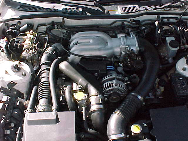

the map sensor is at the firewall to the left of the brake resevoir (about 10 o'clock) and about 1 o'clock from the edge of the TB. i'm looking at a pic of my engine compartment and it looks as if a goldish colored 10mm holds the bracket on the firewall above some metal lines.

for future reference,look at this pic. look at my brake resevoir. now look 10 O'clock to it at the firewall. there is a single bracket with a goldish bolt holding it. it just over a black line that runs damn near the width of the engine bay. matter of fact, just look for the long black line.....the map sensor is on the only bracket that appears ABOVE the line. anothyer way to be sure you're looking at the right thing, look at my pass windshield wiper, look to the right of it and see a large group of grates like a sewer grate. look down and a little to the right. oh yeah, there's a vacuum hose going to the bottem of it.
