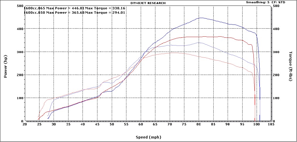

I meant to post this dynochart for a while...
The car belongs to 1STGEN
1983 RX7 FB
13B- REW street ported
550cc/1600cc injectors
HKS cast manifold
T72 hyrbid turbo ( T66/T72 turbo)
Microtech LTX8
SLIPPING CLUTCH
Tuned by Alamo Autosports in Arlington, TX

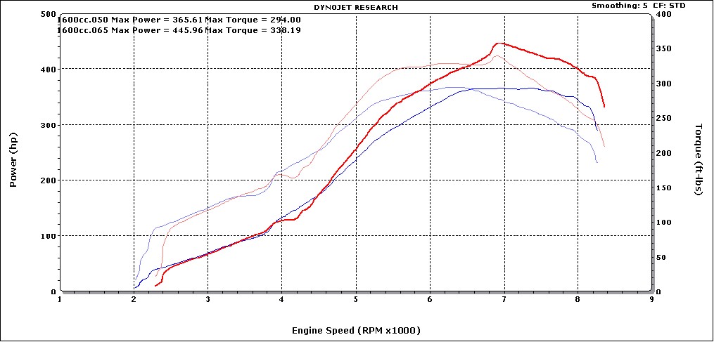

Nice, Can you post a sheet with engine RPM as well? Pics of the car too?

Under rpm, you can see the clutch slip.
I can get some pictures next time the owner comes by.
He is getting a new clutch, so we will retune with the new clutch. He also has exhaust leaks, and we tuned for 10.8 afr, but it felt like 10.0.
So with the new exhaust gaskets, a bit less split, and a bit leaner afr, we are hoping for 470whp at 1bar boost

Impressive. Keep up the good work!

at is impressive for 9spi!!! damn you and your standalone!

ah. thats damn impressive still though. has to be some good tuning involved

Actually the car is tuned really conservative. The owner does not want me to push it. I suggested a C16 map, but he refused. And he wants to run 15psi on pump gas not more
But believe me, the car is INSANELY FAST! I have tuned many high horsepower cars ( 800-1000HP), and this rx7 can really hang with some of them. I guess the weight of 2000lbs helps to run with a 800hp Supra ( 3600+lbs).
