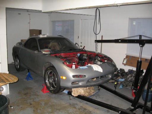

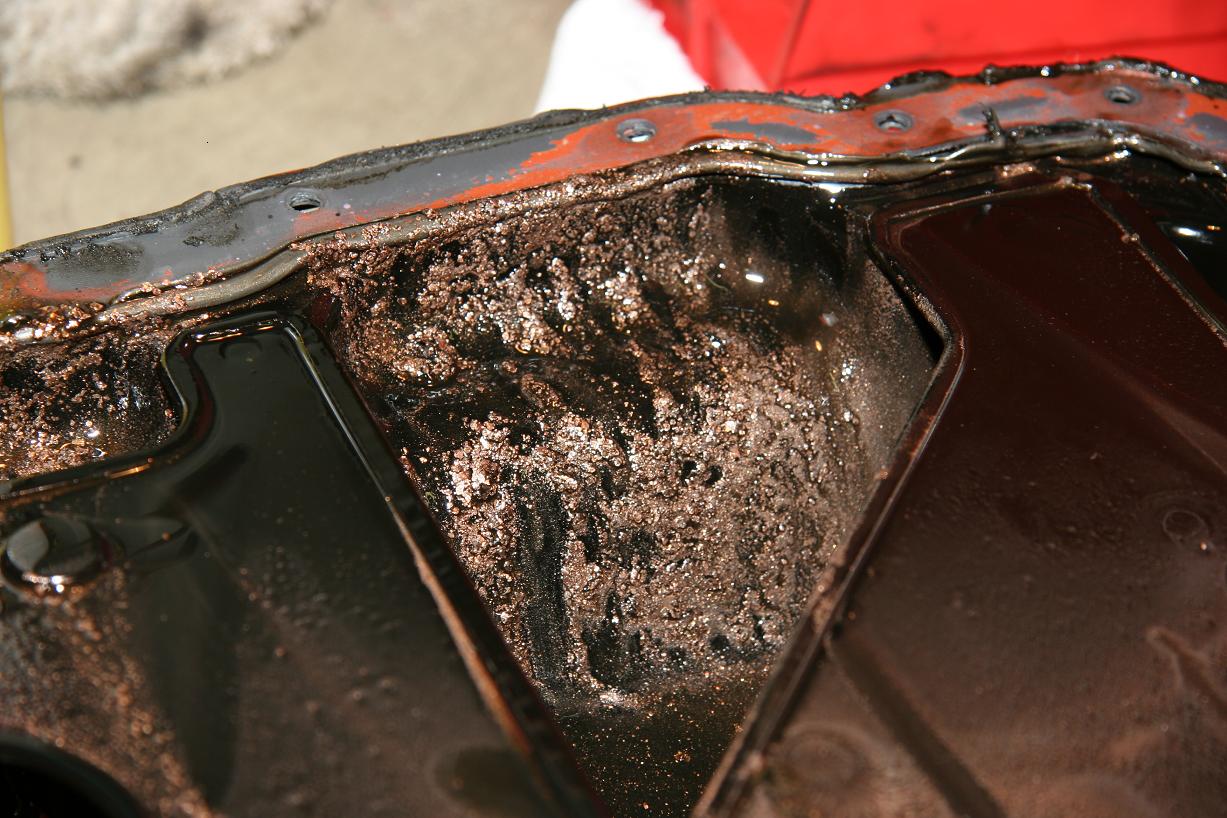

Well, the motors out of the car and at Pineapple for a rebuild. Damaged the rotor bearings by starving them for oil and then detonating on top of it when I ran out of gas at PIR. Hopefully that's the only major damage done to the engine. Apex seals a Ianetti's and they look fine.
Starting to strip the car for a proper paint job instead of the Matco Special I have on mine.

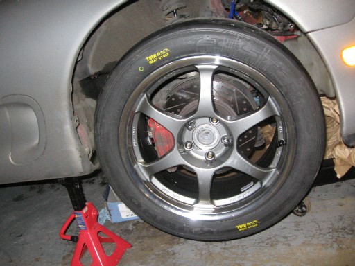

Just got my SSR Comp-H wheels (15lbs each) and V710 tires in last week too.

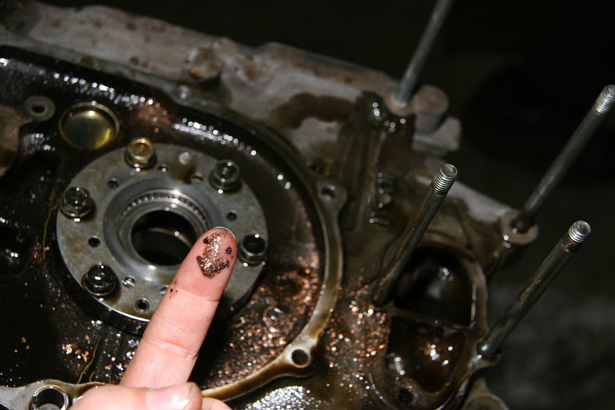

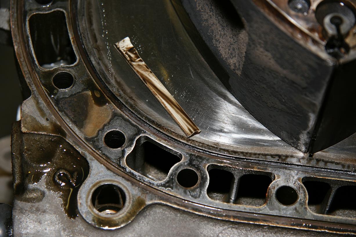

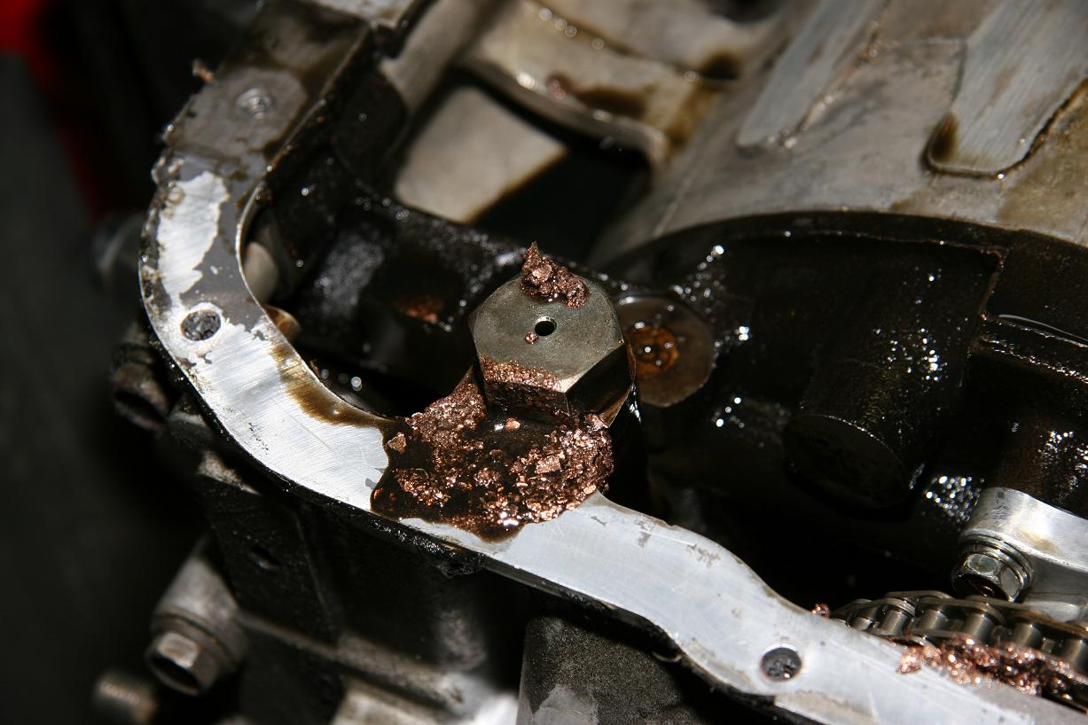

Oh ya this gonna cost me $$$$. Spun a bearing and broke a one piece ceramic apex seal.
Enjoy in my pain. Pan'n for gold are ya.
Yaaaa, I wanna go to Hawaii!! Yaaaa

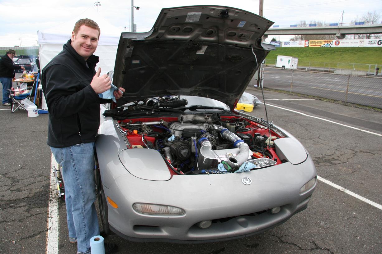

If thats you by the silver FD in the one pic then I remember you. I was co-driving the black FD in Yakima last year and racing the emerald mica 99 Miata in Packwood at the pro-solo and some of the other events. Sorry to hear about the car, I look forward to seeing it when you get it all put together. I am sure you are aware just how much work it is to build a V-Mount. I think those one guys said they had over 100 hours in theirs, but it would be worth it for racing on the track.
Old Apr 14, 2006 | 06:49 PM
Joined: Jul 2005
Posts: 2,913
From: Kingman, AZ

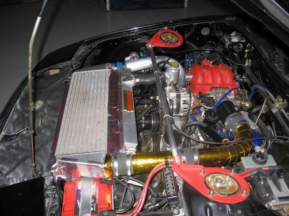

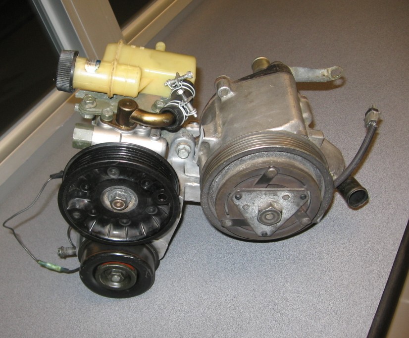

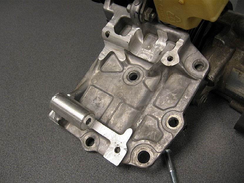

Actually I was one of the guys who did that V-mount on Cartapex's FC. And your right it is a lot of work. I'm currently relocating the Air pump to the A/C pump location to create more room for my custom ducting I will be making for the twins and intake. Required a lot of machining.

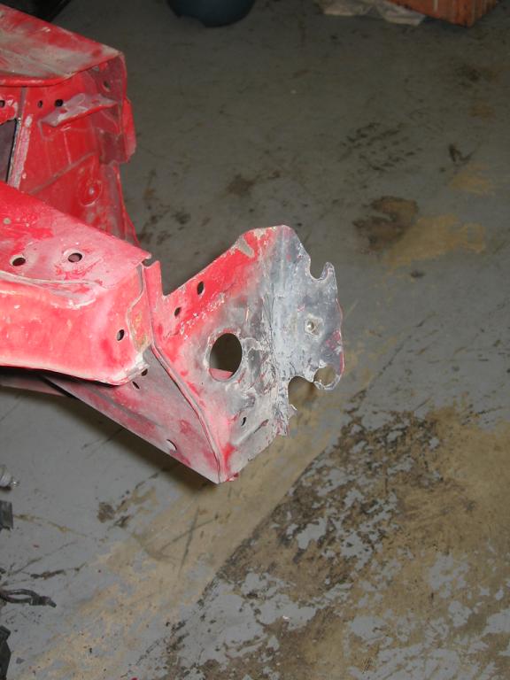

Well found some front end damage repair work on the right front. Whoever did it wasn't very good. Going to have to buy a replacement piece from mazda and weld it on.
Soda blasting the chassis next week!!
Yaaa, Retarded Fender Guy, Yaaaa

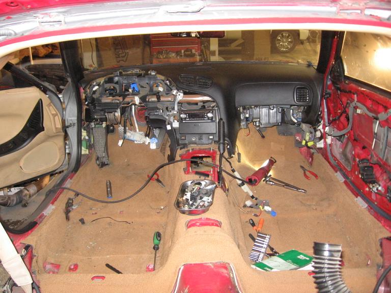

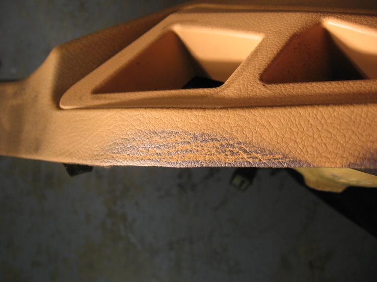

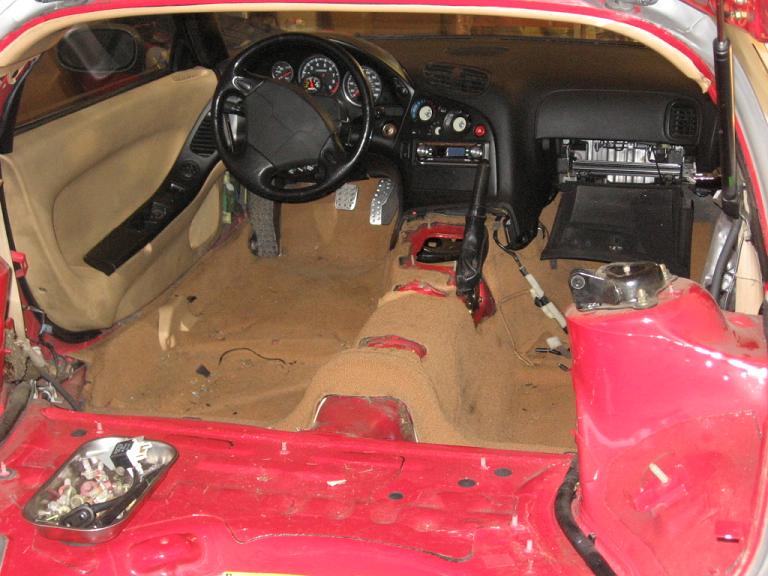

Update

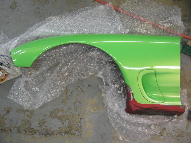

Got the fender that I won off of ebay; opened the package and I was like...WTF?! That's a green fender.
This picture of the interior shows how cheap my old paint job was.
Fender damage, going to have the body shop check if the chassis is even straight.
Soda Blaster guy is going to pick up the car Monday.
Peace
Attached Thumbnails The FD Restoration - $$$$ Damnit-forum-safe-6.jpg   The FD Restoration - $$$$ Damnit-forum-safe-7.jpg   The FD Restoration - $$$$ Damnit-forum-safe-8.jpg   The FD Restoration - $$$$ Damnit-forum-safe-9.jpg   The FD Restoration - $$$$ Damnit-forum-safe-10.jpg
