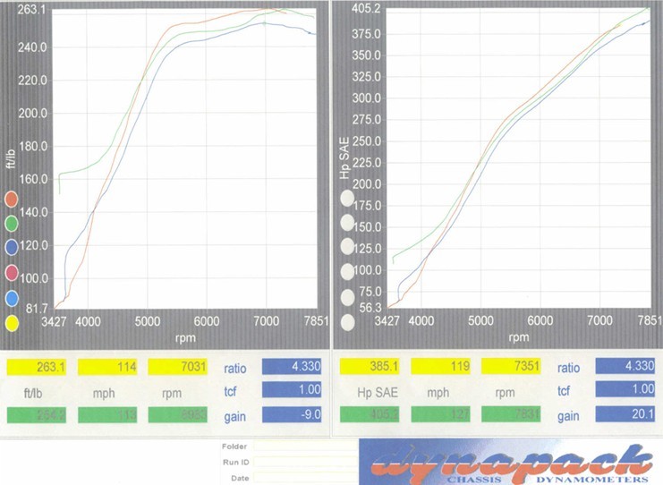

1FastT2's Avatar
Posts: 1,790
From: Sinking Spring Pa.
Originally Posted by Havoc
If that's just on pump fuel, that's the second highest recorded hp Ive seen on a 60-1.
Some guys have got higher but its been with additives (AI, WI or c16 etc.) Which is kinda cheating when comparing like turbo's.
Post up your dyno to show the others mate. Good for tech reference. so others can follow.
https://www.rx7club.com/showthread.php?t=742289

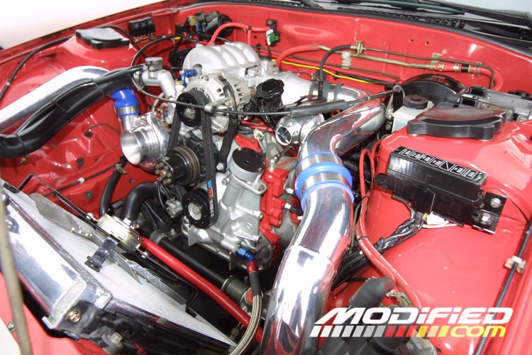

It was with Sunoco 94oct with about 15-16psi. I'll see if I can dig out the dyno sheet, this was back in 2003 when I put down those numbers.
FOUND IT!!!
Pic of the setup.
Attached Thumbnails T60-1 with a 0.84a/r too small?-dynochart.jpg   T60-1 with a 0.84a/r too small?-modified2.jpg
