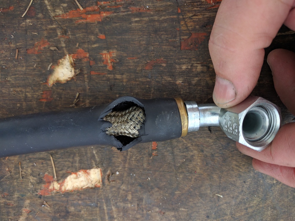

I like how you did the plumbing with hard line no worries about if the hose can stand up to being submersed in fuel, I had a failure on the feed hose inside the fuel cell even though it was proper submersible rated hose. I am sure that the hose failed when we had a problem with a blown out muffler and missing heat shield that got the fuel in the cell so hot that it boiled out of the vent tube and ended up setting the car on fire. For now I have -8 braided hose in the cell but I have considered going to hard line to eliminate any possible problems.
wow that's crazy! Not sure how hard line (tubing) would work in a cell. But I don't see why not
