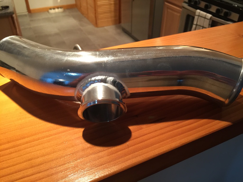

Not ready to put it in but test fitting for proper BOV Flange location. Going to get it welded on this week.

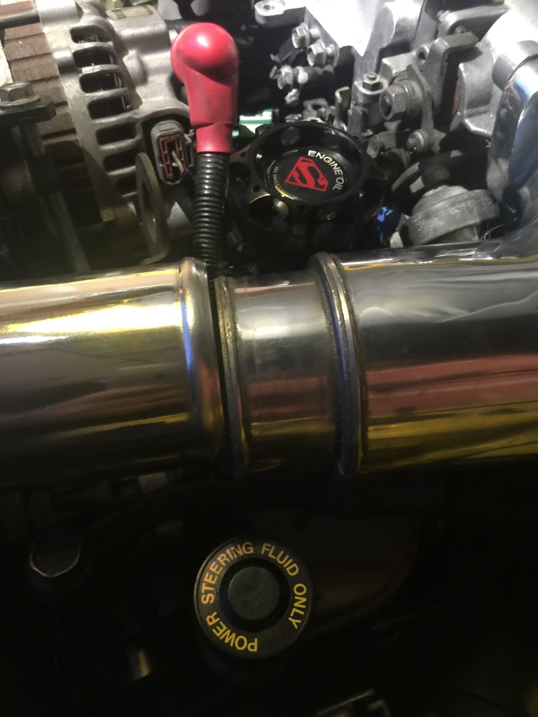

I'm tackling the Greddy V-Mount installation right now myself. I need to relocate my remote shock canisters, catch can, relocated coolant overflow bottle, and AST. I'm wondering if the slight penetration of the IC pipe into the IC was a design feature specifically for your issue. I couldn't think of any reason why only the IC exit happens to be 3 and 1/8" instead of 2 and 3/4" or 3". I was worried I wouldn't be able to find a silicone coupler that size, since I don't want to use the powder blue ones it came with.

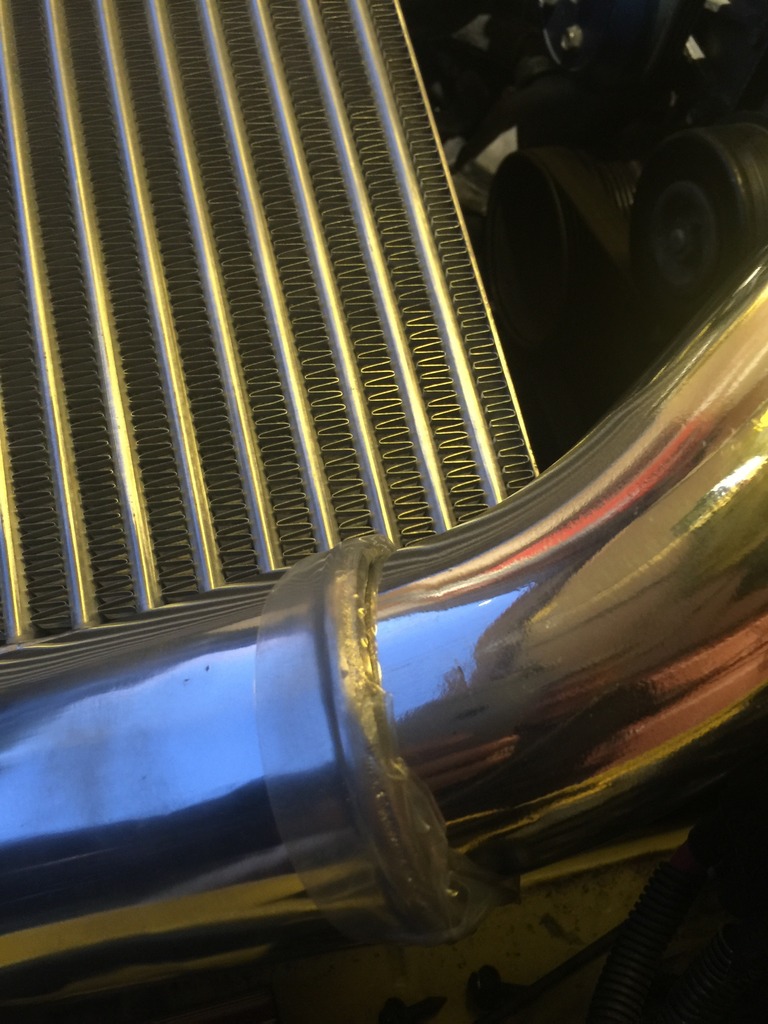

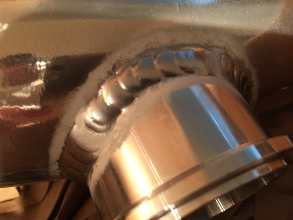

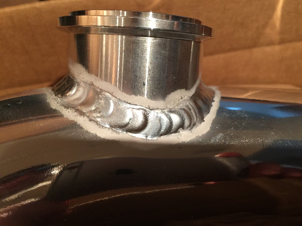

Got the Tial BOV flange welded on. Paul did a nice job. Paul is on FB "PNR Welding" and is an avid bracket racer.
https://m.facebook.com/pnrwelding.net/

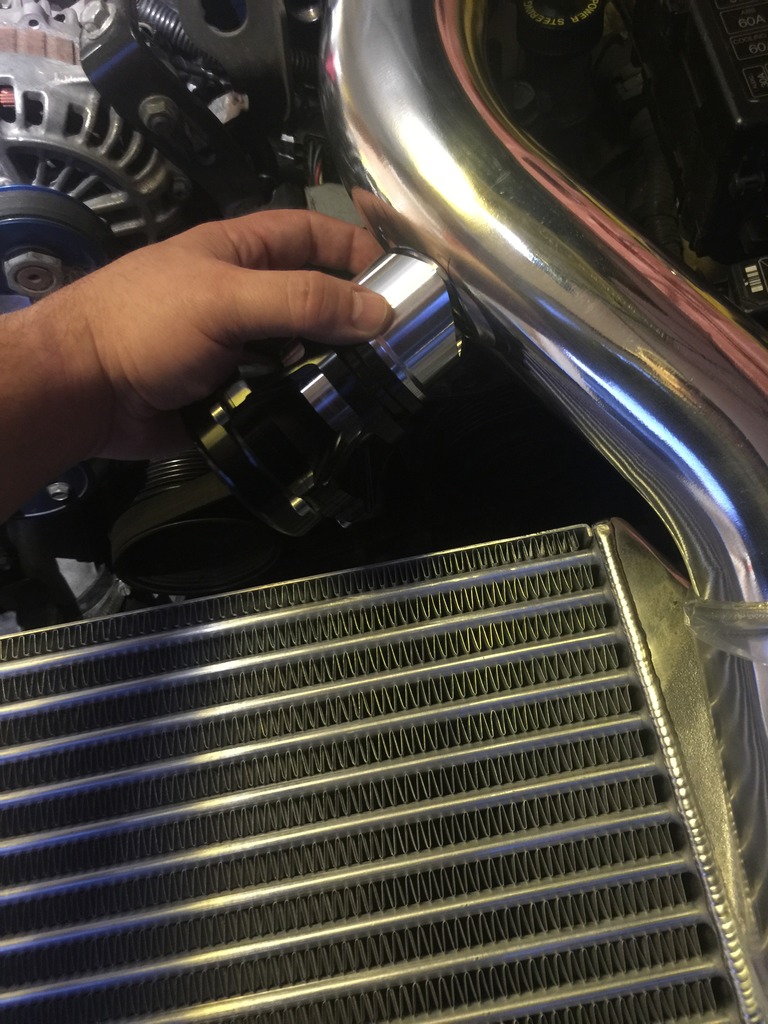

I have a completely stock Greddy V Mount full kit. I didn't plan on using the stock couplers either.
So the IC piping is 2.75. The hot side of the IC is 2.75 and the cold side of the IC is 3.25. All the IC piping is 2.75. I checked both sides of each pipe. Looks like I will be buying a reducer for the Cold side. The blue Greddy couplers that come with it look like flimsy junk so never planned on using them anyway.

I measured 3.125 on that cold side IC. HPS actually makes a 3.125 to 2.75 reducer. I also have to have a 2.5 to 2.75 reducing 90 degree elbow to come off my EFR turbo.
You are probably right about the cold side of the IC but I think a 3.25 should work without leaking with T-Bolt clamps. I was looking at the HPS and Vibrant Reducers.
As far as the hot side. My turbo has a cast elbow welded onto it that is 2.5 and already had a reducer for that side from Mishimoto.

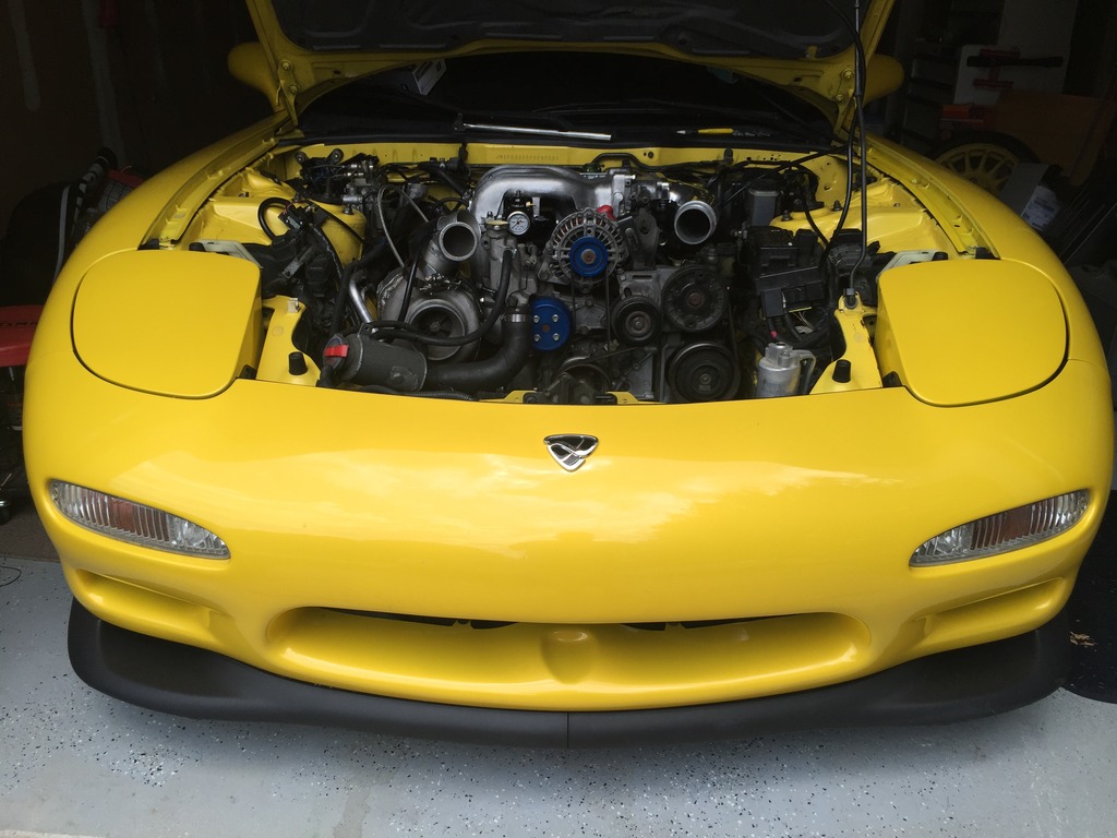

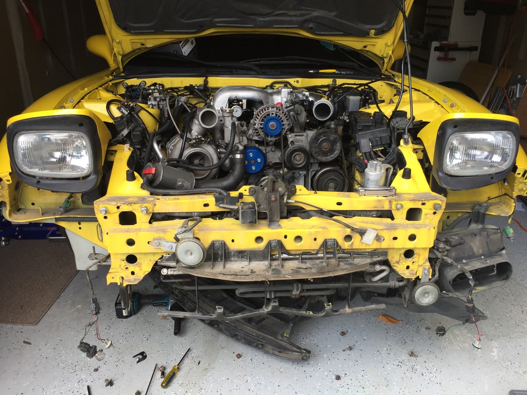

We have been having some very high temps all month and it's been difficult to get out and do some work on the car. I noticed a break in the weather for today and took,a vacation day. I got a lot done. This weekend will be 98-99 degrees. So it won't progress very far unless I get up at dawn and work for a few hours.
So this is how we started the day.
Then removed the nose and fender liners.

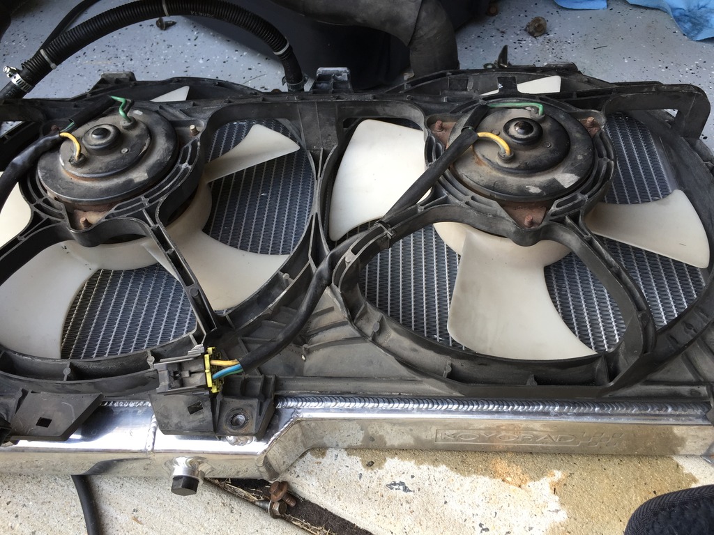

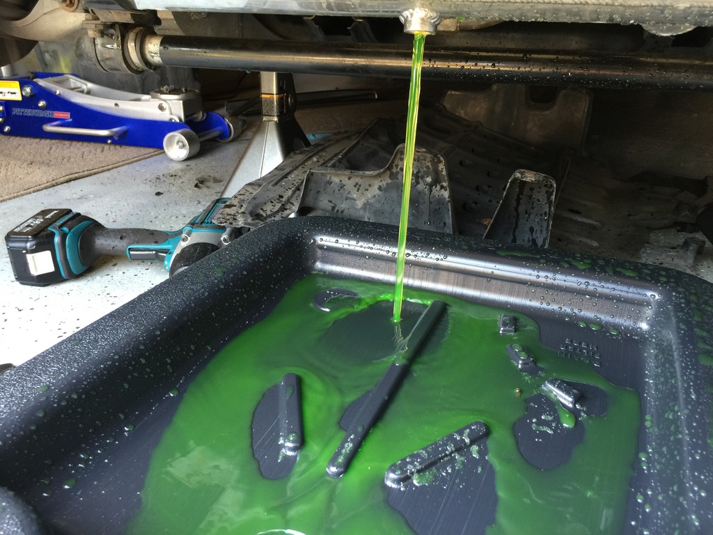

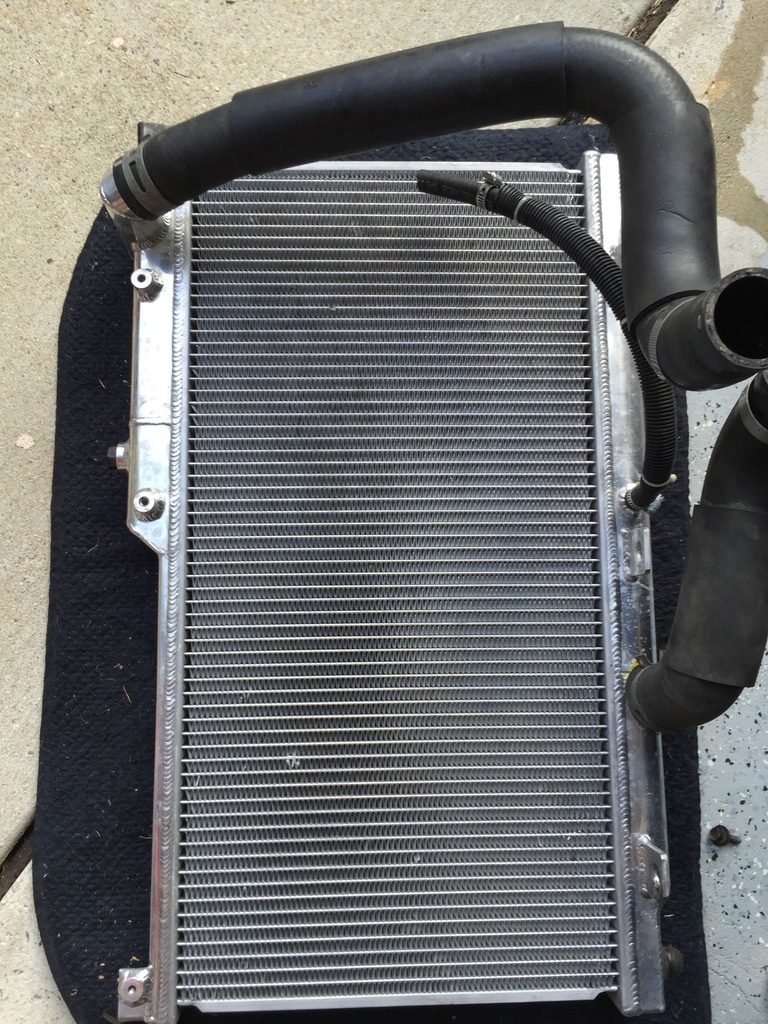

Drained the coolant from the Koyo N-Flow radiator that looks basically new still.
Removed the fans from the radiator.

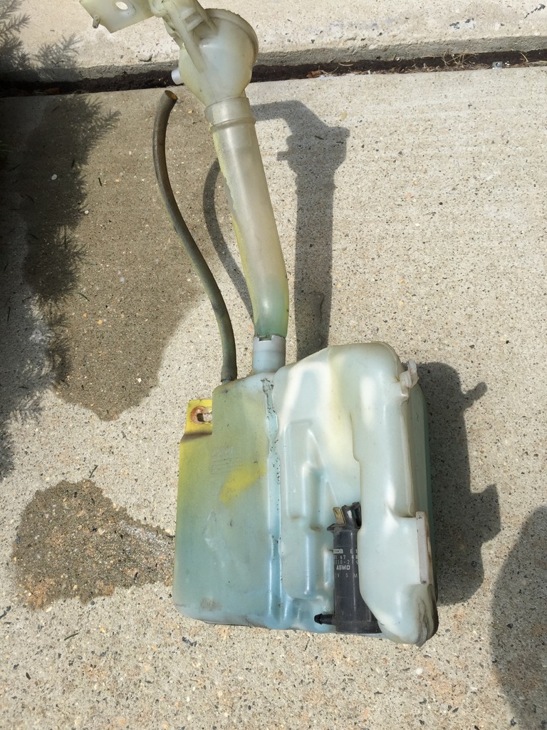

Old washer tank, have new washer and overflow tanks so took out the old ones and they look serviceable so I may sell the old ones.

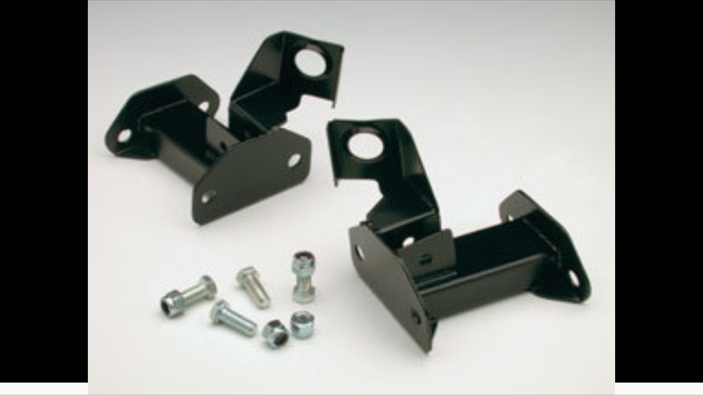

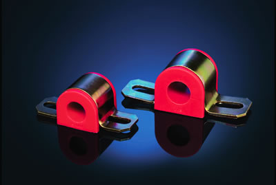

Last night I decided to order the AWR sway bar mounts. These replace the weak stock mounts that always bend and crack. This is a must do item and anyone who tracks their car at all should already have done this. I also ordered the Polyurethane sway bar bushings as mine has the stock rubber bushings and I could see they are deteriorated. It's a nice mod for the 93 cars that have the larger rear sway bar as this stiffens up the front and has a similar effect of a larger front bar or a smaller rear bar.
You can find the sway bar mounts here.
Sway Bar Bracket - 7304 ? 1993-1995 RX-7 - AWR Racing Store
And the sway bar bushings here.
https://m.summitracing.com/parts/ens-9-5112r

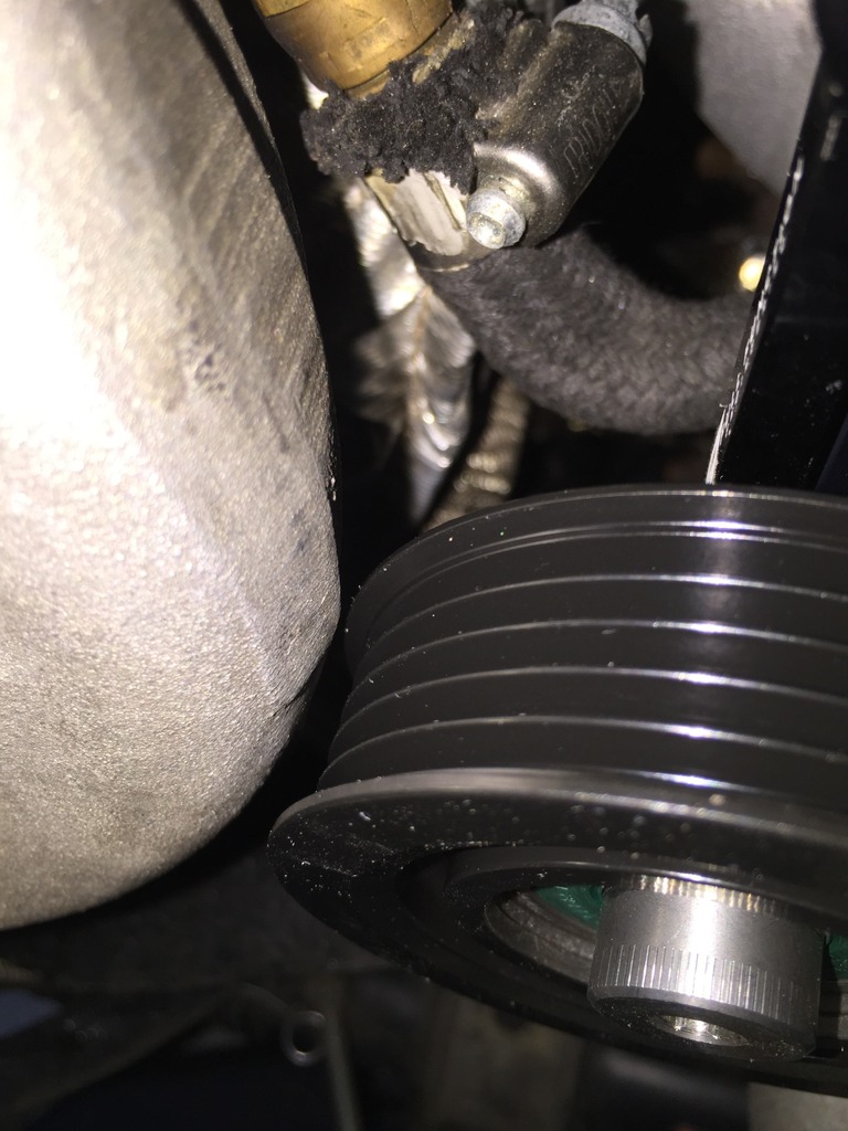

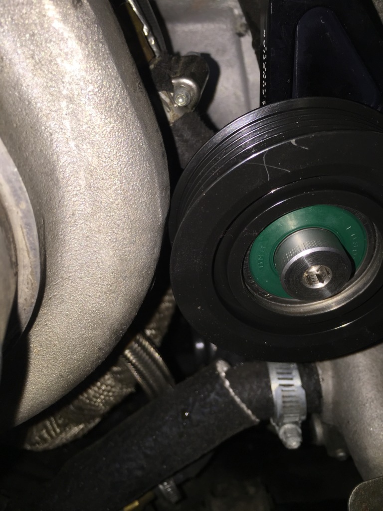

Ok back to business at hand. It's hot and humid. I can't stop this train. Must keep pushing thru it.

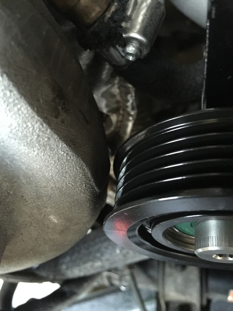

So my Full Function Engineering Idler pulley fits... But it's tight. Real tight. I may grind a bit off the compressor housing depending on how it looks when I get a belt on there. Have a look.
Little bit of air in between lol

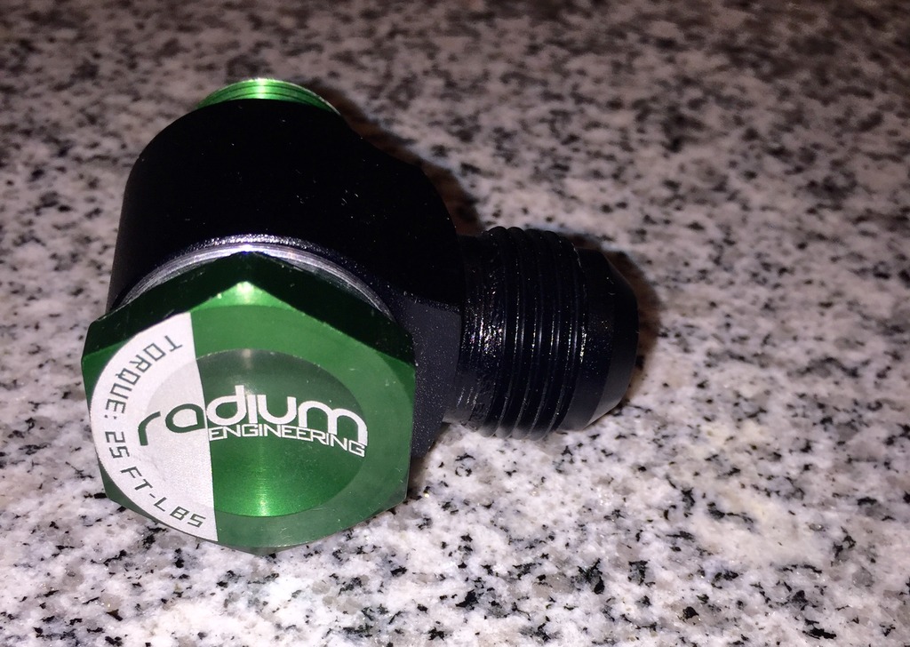

For those of you with the IRP oil filler neck with the -10an bung for the catch can. I have been trying to find a nice Banjo Bolt to work with it. I picked up a couple but the one that fit is the Radium. It is -10an by 7/8 Orb. Yes any -10an would fit but I have yet to see a Banjo Bolt that is -10an on both sides. One seems to always be SAE. I threaded it in and it fits nicely.
So for those of you wanting a nice looking Banjo Bolt for your nice IR Performance Oil filler neck. Here is your solution.
