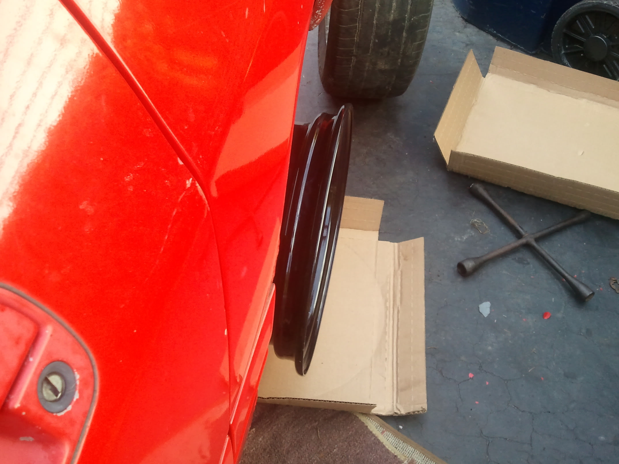

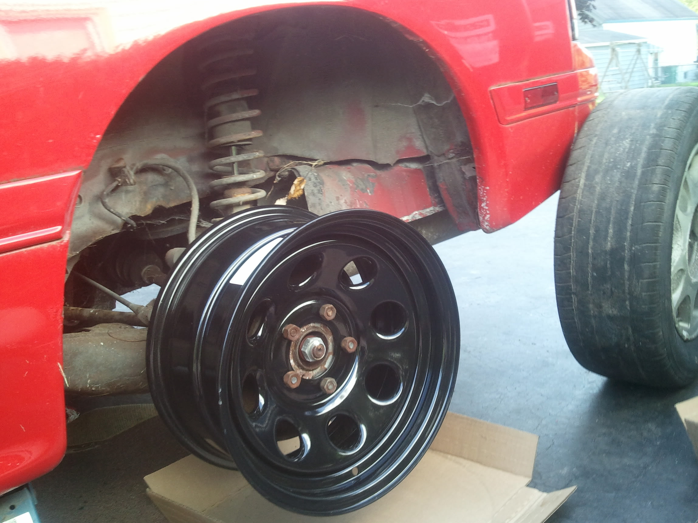

Anybody got an idea were i should start, tri point super wide fenders id say there 50mm front and back but not sure. i have 36mm hub extenders to build off of, what rim width, offset, and tire size, should i go with? i dont care about being legal i know muscle car guys arent following the rules with there tire sticking out past there fenders.

What do you guys think of these?
cragar soft 8s
5x114.3
15x7
0 offset
can i get a good tire size if these will work from ya guys?

those are stock rear quarters but im thinking of mounting these rims under those tri point fenders up top plus ive got 36mm spacers and a bunch of 5 mm ones too to work wit i want a flush look

You're planning to space 15x7" wheels like a foot out to try to fill those??? wha? really?
no im trying to find an aftermarket wheel that would work those cragers are just some wheels that someone wants to sell me they have a low offset thats what got me interested but im not really feeling them any help would be great, i need to figure out a offset and width thats gunna work wit the tri point fenders
