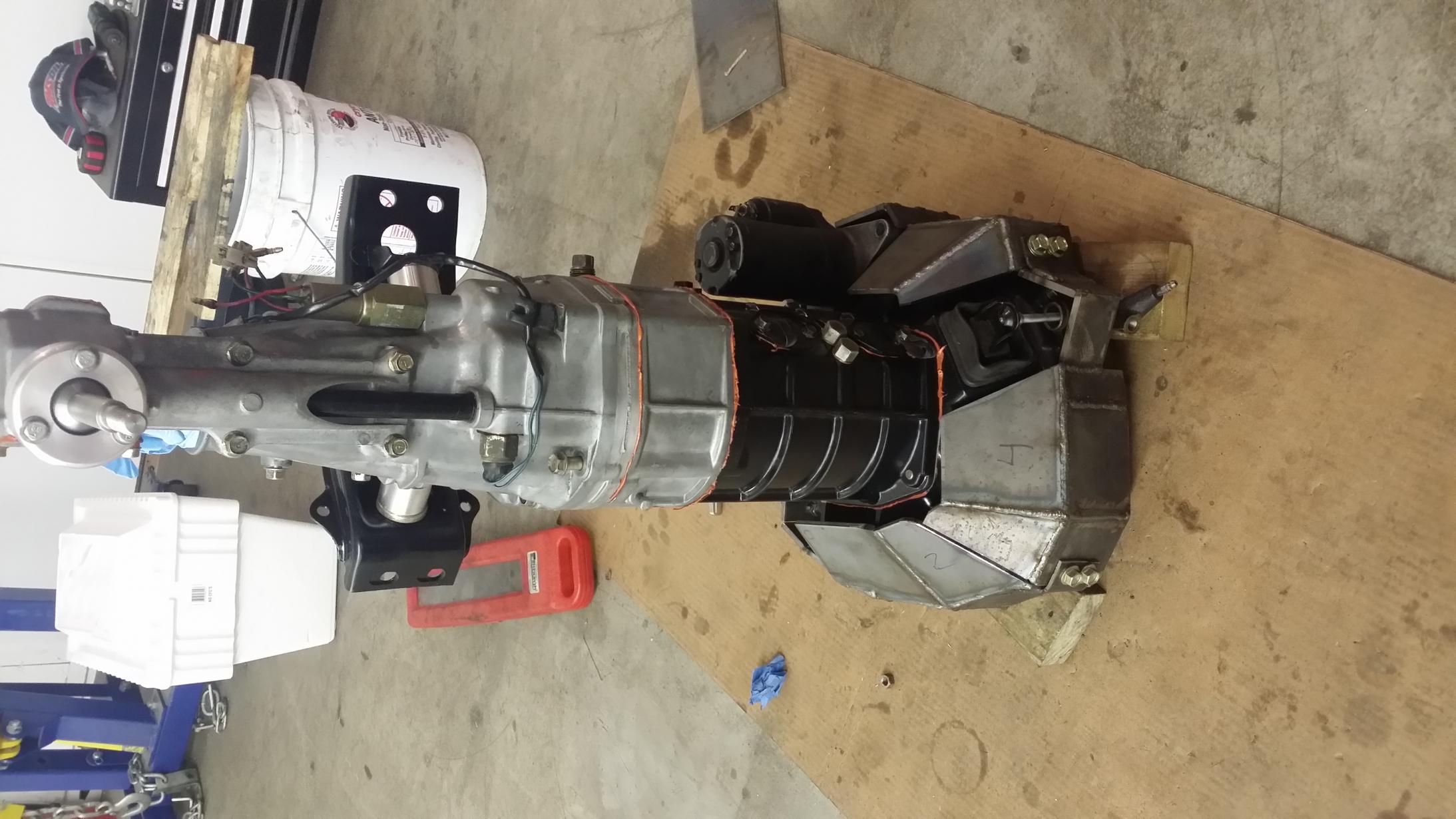

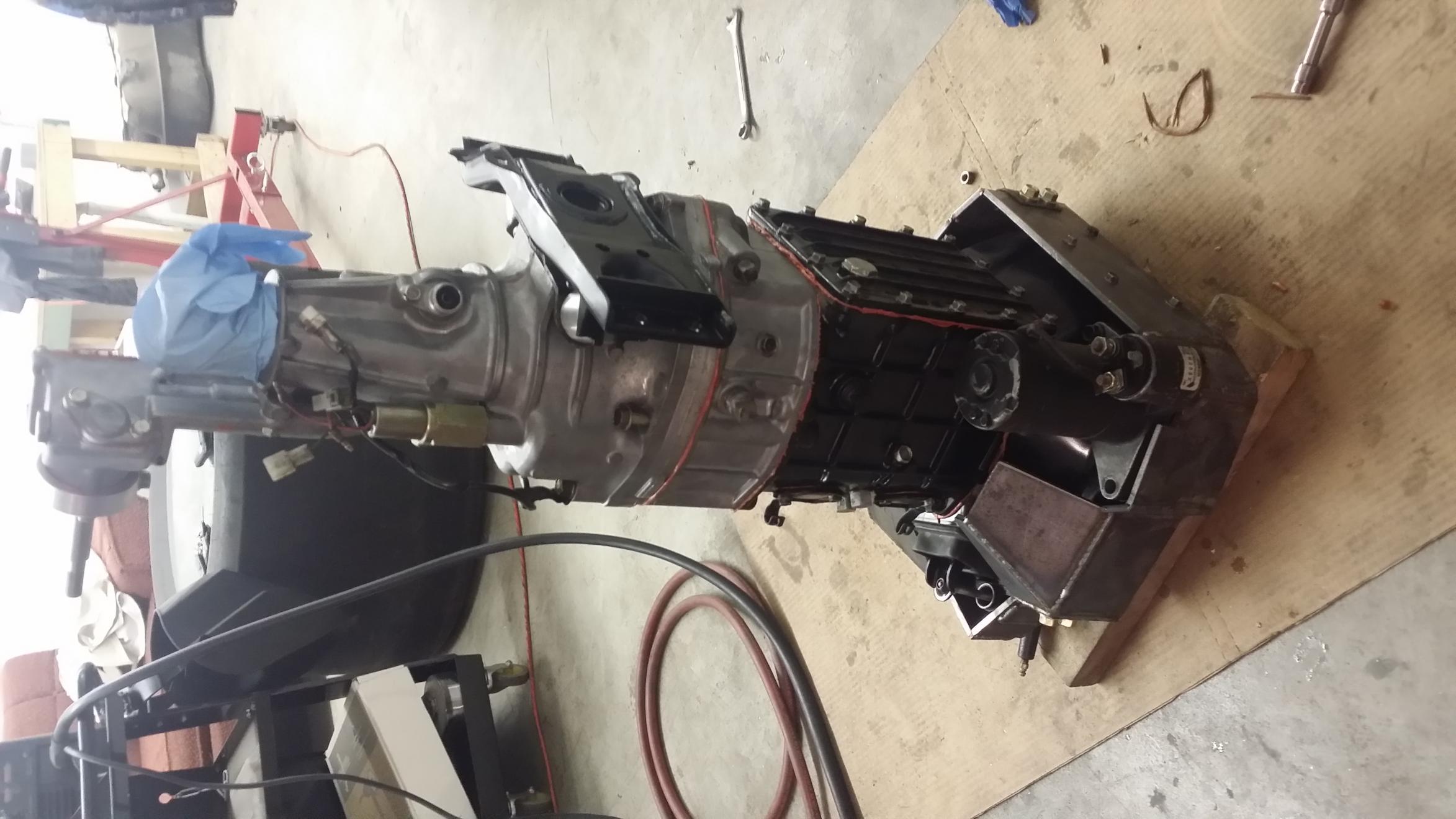

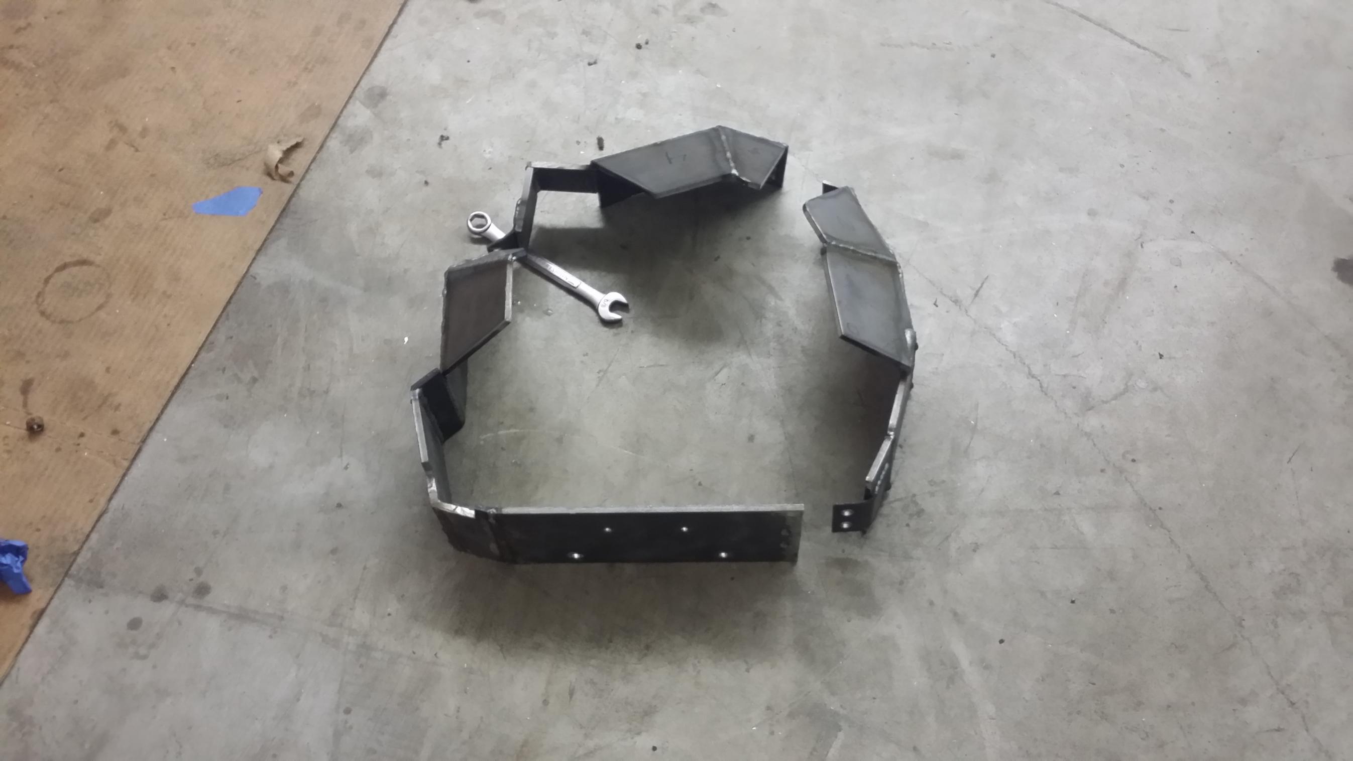

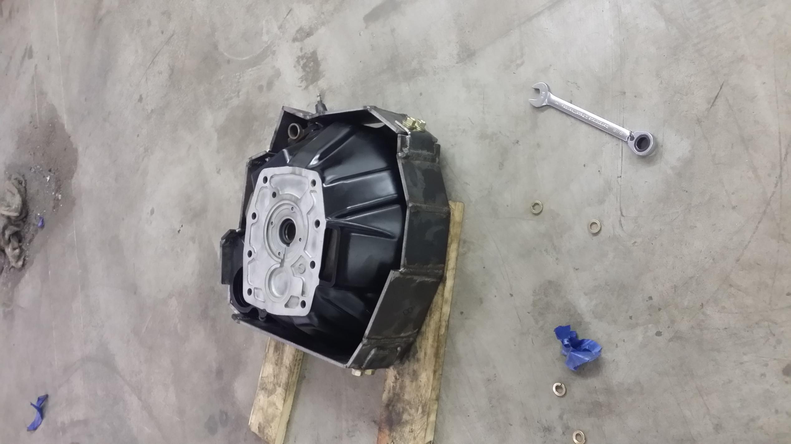

I took your advice, here are some pics of the scatter plate I came up with. It also comes apart in 3 pieces.
Attached Thumbnails T2 Scatter Sheild-20140716_165828.jpg   T2 Scatter Sheild-20140716_173438.jpg   T2 Scatter Sheild-20140716_173454.jpg

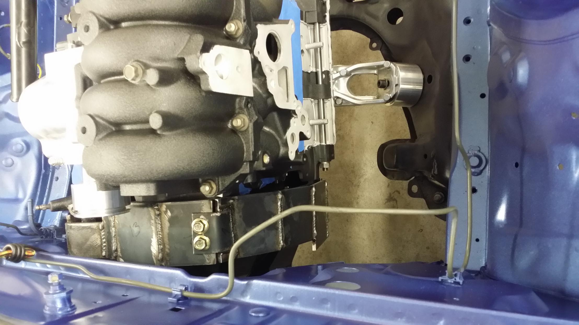

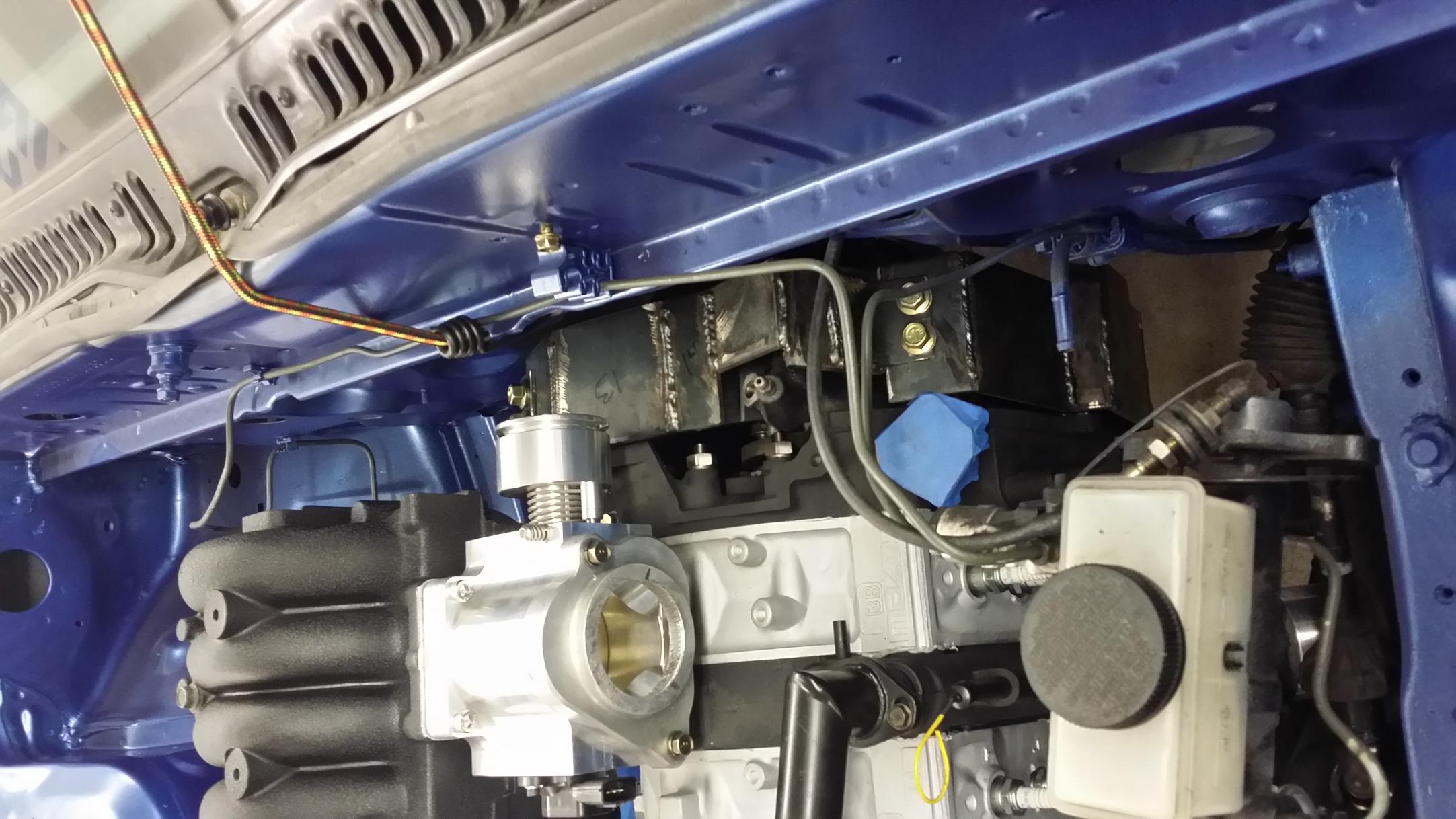

Scatter Sheild completed, I tried to make it impossible for the flywheel to get out
Attached Thumbnails T2 Scatter Sheild-20140804_004359.jpg   T2 Scatter Sheild-20140804_004910.jpg   T2 Scatter Sheild-20140804_004930.jpg
