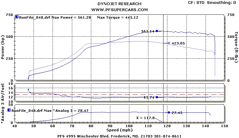

Also, you might want to check your dyno chart, if you have one. I'll bet your power is already falling off before 8,000 rpm, and T56s have been proven to handle 8,000 rpm just fine.

Originally Posted by jimlab
Neither was the OEM 5-speed...
Thanks Jimlab, thats all I was looking for, it was recommended to look into by Ray anyway as I keep shearing off the teeth in third gear rolling into full boost. Something to handle the torque, as I am making decent torque. I also have found that they make a T5 setup as well (gforce)
My torque drops off before that anway
