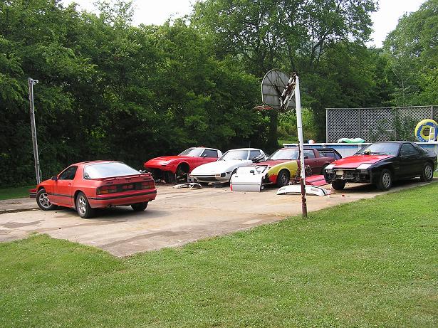

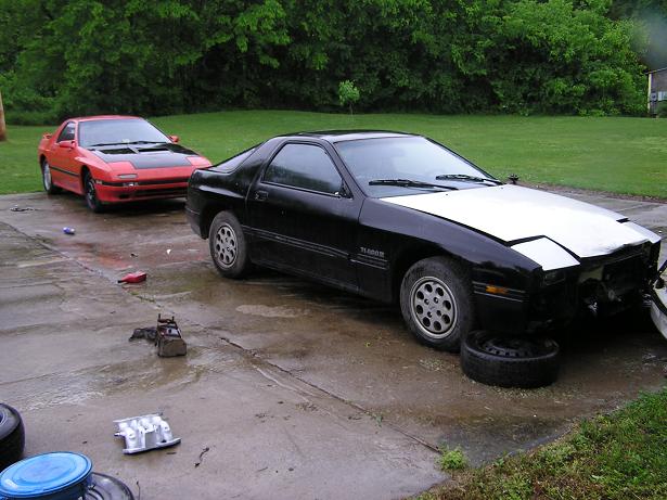

I have a 1987 T2 that I am putting a N/A 13B in.... The car is basically trashed but it should be a fun run around/ SCCA beater. Here are the pics of it.. it is the black and red car..lol well also the black and white car... depends on what pics you are looking at.. BTW it is also rolling on a 4 lug suspension, I have most of the 5 lug bits so it will get that back......anyways throwing the motor in next week, I will post up results... I am probably painting it a metalic blue, something like that. I have a set of BSA 17" wheels with new tires waiting on the 5 lug swap... should be fun.
