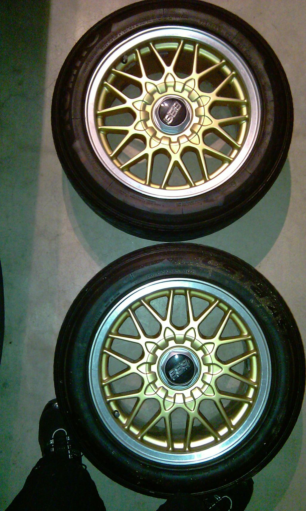

ok i have a set of 4 of these bbs 16x9.
Im looking to put them on my second gen vert that has f & r eibach springs.
they came off a second gen coupe so i know they fit.
my question is iam I able to run 225's on these rims up front?
will it except the 225's?
can i use spacers on the 16x9 with 225's up front?
or should i go with 205's up front and 225's in the back?

well I put the 225's on the driver side front and it wouldnt seat right against the hub without the spacer.
I dropped the car down with the 225 up front onto the ground and It went down without a issue.
It just felt real close to the strut and didnt want to cruse with these and hit a bump and .blow out a tire
so thats why I ask if anyone is running 225's on the front of there 2nd gen.

AZ 16x9
The rears Im not seeing any issue with it possibly rubbing, only the fronts seemed close.
I threw a 5/16" spacers on front with 225 50 16 tire and i just seemed really close between the strut and eibach springs.
Im not sure what the offset is.
