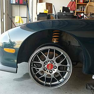

just to clear Some things up officially. The front usdm FD brakes can fit the RG-R in 17x9 +42. With additional 3mm brake clearance, no Spacers needed
Thanks for the follow up. Makes me want a set in 17!
