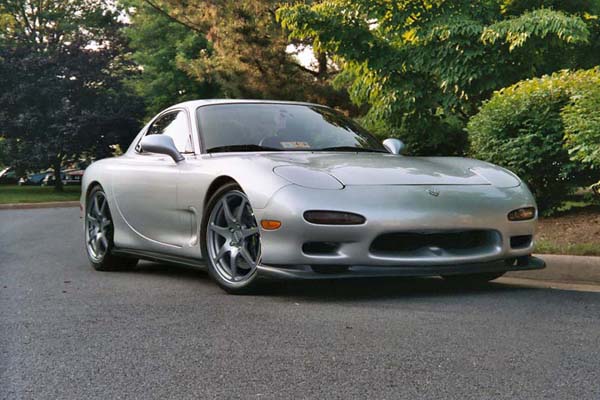

The 18x9.5 +44 weighs about 18 lbs and change, and they come in a cool anthracite they call "British black"... they are very hard to find stateside, but i do know of one place:
www.scienceofspeed.com
Check the pics of the BB versions on the white NSX...
Pan down to the pics of the yellow sanai rx7 to see how they look on our cars....
https://www.rx7club.com/forum/showth...hreadid=216220
They're all business, but in a good way.

Here ya go... i even 'shopped on some Feed skirts!

Nice

I think 5 spoke or mesh are the only two styles that look good on an FD.
