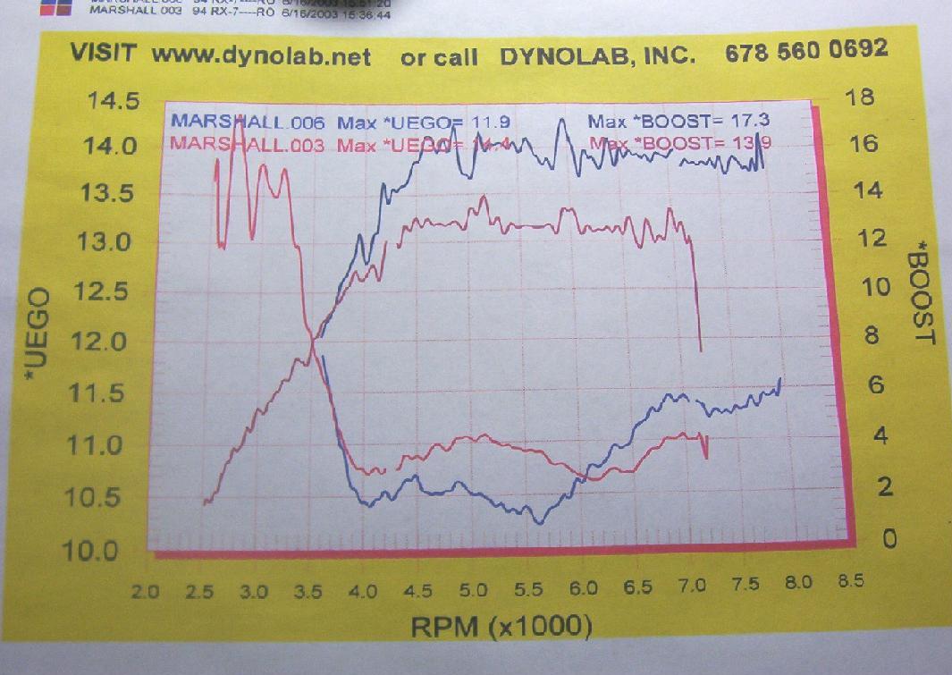

I went 10% richer in all boost areas over Chuck's map and was under 10:1 on the AFR on my first pull. Pulled some out (a breeze for me, a tuning idiot, with the datalogit BTW) and got it right where I wanted it -a tad under 11:1 at peak torque moving into the low 11s on up to redline. Tweaked a little more.

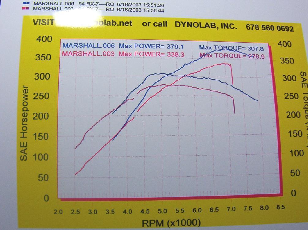

Here are the numbers at 15.5 psi and 12.5 psi and, though the numbers are SAE corrected, it was 95+ and humid in the garage bay so it would probably be higher at actual standard conditions since turbo cars will do that. The sheets show power, boost, and AFR. Enjoy!

AFR and Boost

Something interesting, it made more power everywhere over Schlagheck's 1.32 AR AND street ported setup at the same boost. It also peaked at the same rpm. Whats up with dat?

The knock was under 40 with nothing unusual. It jumped a little when I let off. How do those AFRs look? On the red one (low boost) I leaned it to ~11.0 from 6000-6500 afterwards. The blue one I added 2% at 7000. The timing was one of Chuck's maps with a little more taken out around peak torque, the split was 12 deg. It made what I wanted power wise so I didn't want to risk it for 10-15 more hp.

You cound make WAY more power by swapping off that .70 exhaust and going to a .96 or 1.0.
You are choking that thing did you buy the turbo from a supra guy?

Thanks guys, from what read, I honestly expected the power to drop off hard after 6500 with a .70 -but then it went on to peak after most stock port engines (7200 rpm) and continues to maintain decent power to 8k. This is why I pulled up RS's old 15 psi T-66 dyno (1.32 exhaust) to look for that drastic difference in powercurves -it wasn't there (maybe tuning?).
http://www.catenet.net/graph.php?car12=1&SUBMIT=GRAPH
I'm sure I could pick up a few poines with a bigger hotside though but for now I'm going to finish my water injection (budget ) and try a couple 17psi dragstrip passes.
