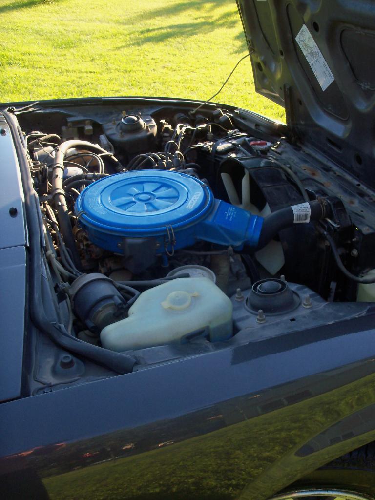

Hey guys, I'll just start off with a few pics and details of the cars: as I promised.

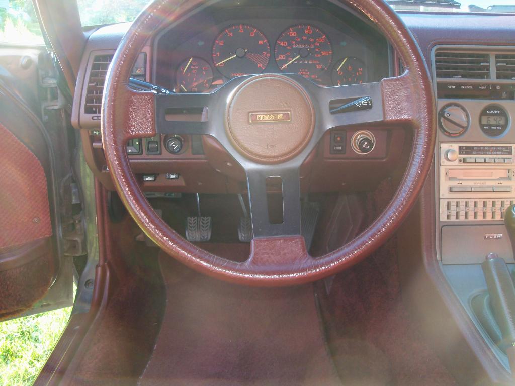

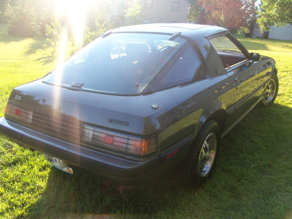

1984 Mazda RX-7 GS
1.1L 12a carburetor engine
Stock engine, trans, rear end
No ECU
Complete burgundy interior

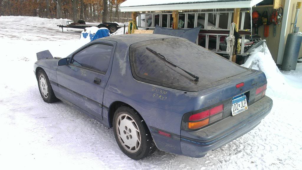

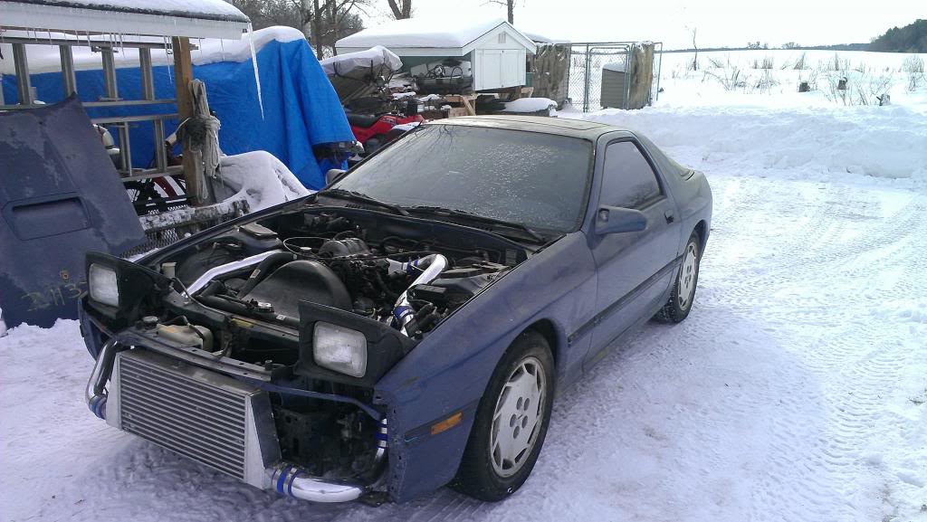

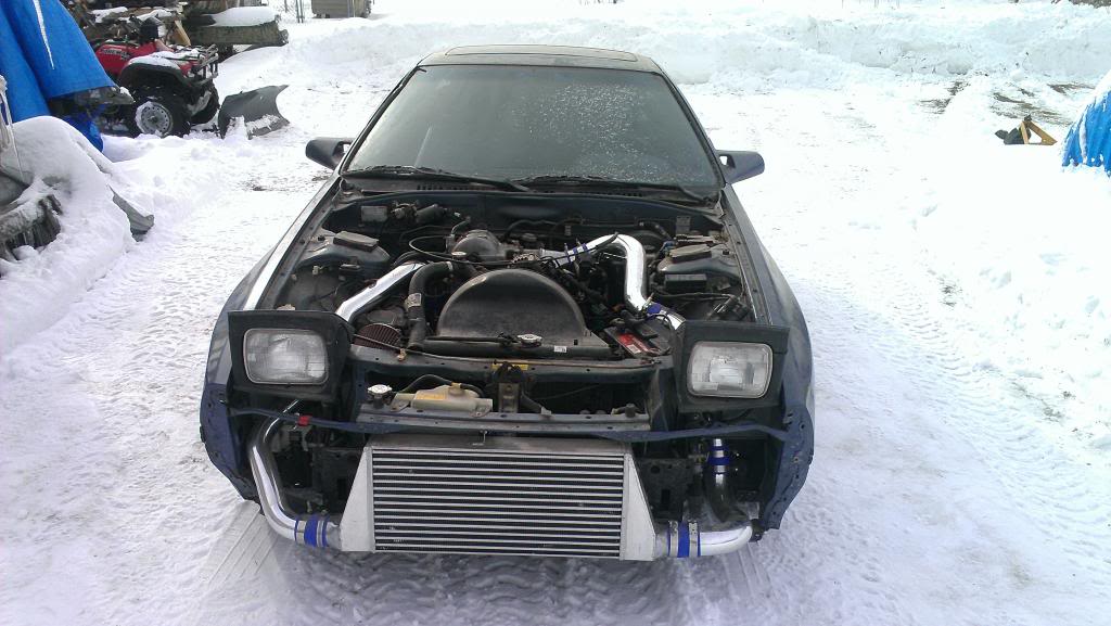

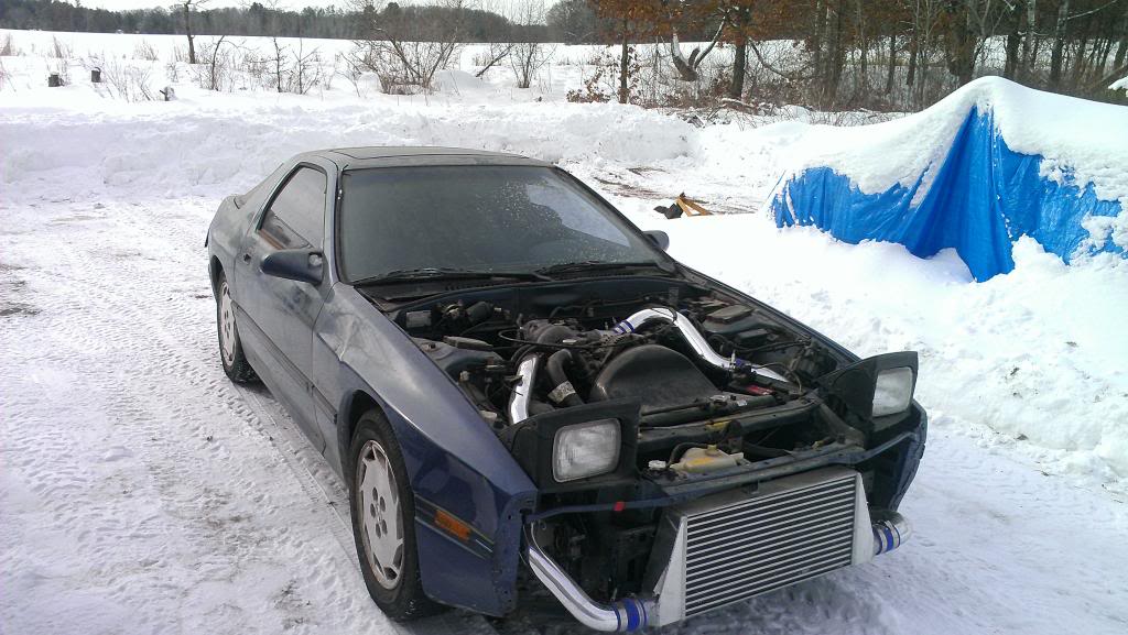

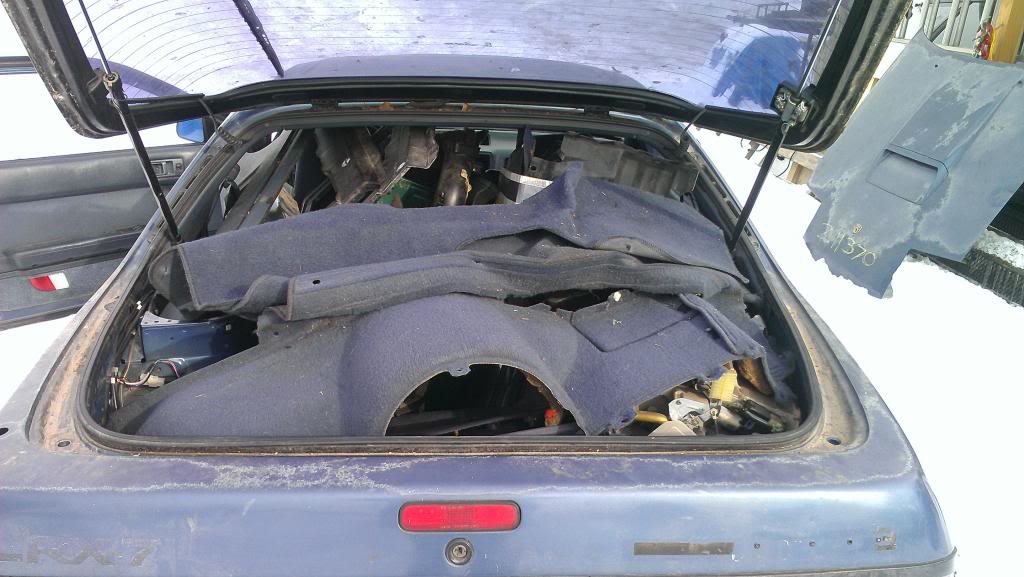

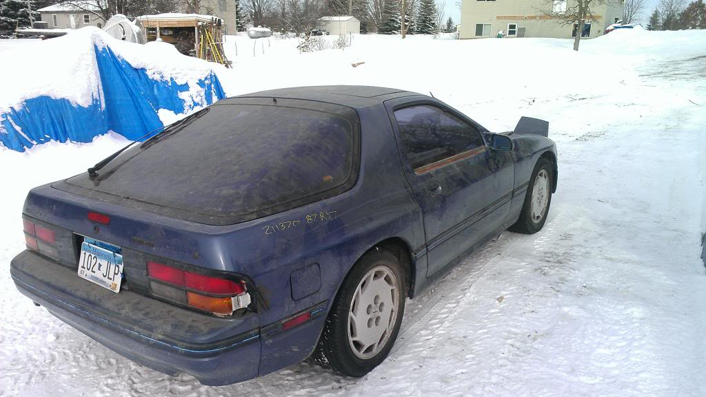

1987 Mazda RX-7 Turbo II
1.3L 13b turbo engine
TII transmission
Stock ECU
Interior partly gutted but should be complete
Project description:
I plan on swapping the TII 13bt engine and TII trans out of the 87 into my 84, along with all of the wiring and necessary parts.

Here are a few tidbits I bought with the car:
A Walbro 255lph fuel pump
A Turbonetics wastegate
An eBay shiny BOV
And here's all the paperwork that came with the car and I may be getting a title for it as well...maybe...
And I found all of this while going through the entire car with all the bins of parts and such that was included in the sale. Among other things was:
A complete A/C system for the S4 engine
Another S4 UIM and LIM
Complete rat's nest
Stock Turbo II TMIC
And some other odds and ends
So today I took the TII out for a spin and that thing RIPS!! Compared to my little, completely stock, worn out 12a the TII felt like a rocket! Unfortunately the plows haven't cleaned up the 3" or so of snow and sleet we got yesterday and into last night so I couldn't fully open her up. I took a video again of my drive and will post it as soon as it's on YouTube. Uploading 1080p 30fps video takes a very long time...

It's a blast, let me tell ya. As Sean has told me, the 200hp that makes the FC a fun car will make the FB a rocket and after driving it I cannot WAIT to swap!!
Oh it's ridiculous! And in the video I only took three pulls, and only one of them kind of counted and I am anxiously awaiting the day I get the engine in the FB and get it running
You had my fiance and I literally laughing out loud with that one! I have never typed lol but LOL,
Yeah, it just takes a few times in the ditch and you learn real quick how bad it can suck. I blew out a 4 speed automatic tranny on a 4x4 truck because I got stuck in the snow and had to rebuild it in my bedroom in 2 weeks. I learned real fast after that.
