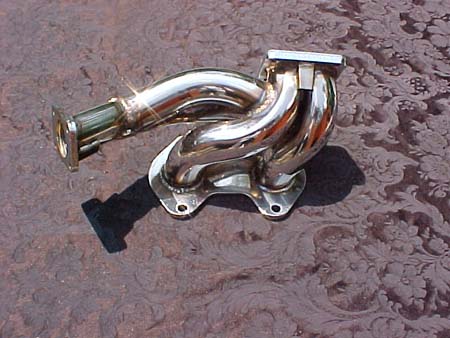

yeah i was looking into that Turbo also and what about the SSAC Manifold. I heard they're pretty good for the price.. but yeah um what you guys think.. i did some search and yeah.. any 1 here running that mani @ the moment.??
