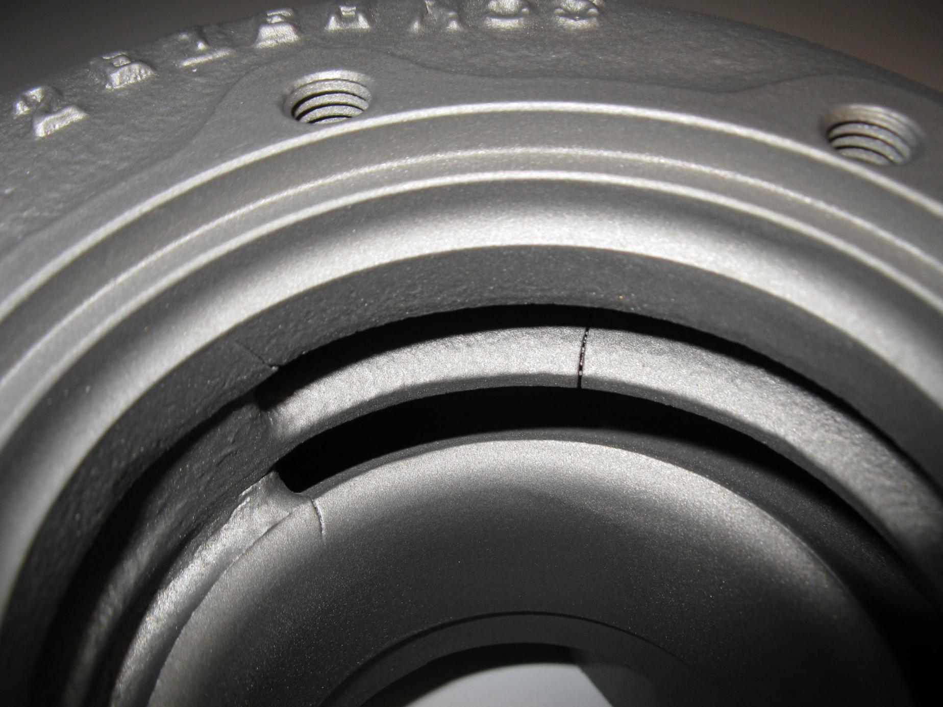

Car boosted great, right around 8 lbs for the first 5-10 miles of driving. No boost creep, no issues, no irregular noises. Then suddenly, there's no boost. I check the WG, it's still connected. Nothing missing hose wise... So I pull off the TID- low & behold the turbo is SIEZED! I can not turn it by hand, at all.
oil pressure gauge read oil pressure the whole time, no leaks. Coolant full & good, no leaks there either.
When I had the turbine housing off for porting, I did notice a crack both on the flange, about 1/4" long, & another around the turbine wheel (see picture, not my pic, but the same type of crack.)
rotating assembly on turbo spun great, though with some slight drag (though this is my first turbo car, so I thought it normal. No grinding or rubbing or anything, it just would come to a stop in 1-2 sec when flicking it w/ your finger while on the bench.
so, my question to everyone, is, what on earth happened?? I'll be pulling this one off soon & investigating. Need a rebuild at the very least, for sure. haha. Would just like to know WHAT failed so I can prevent in the future!
Thanks!

Unless there are signs of the compressor or turbine contacting the housings, the bearings are done. If you disassemble the rest of the turbo, you'll probably find signs of wear and/or blueing of the shaft. It's hard to say what exactly could have caused it until the rest gets disassembled. There may be debris in the CHRA or carbon coking.
Minor cracks in the castings are normal with age. This has been asked 3-4 times in the past 2 weeks.
