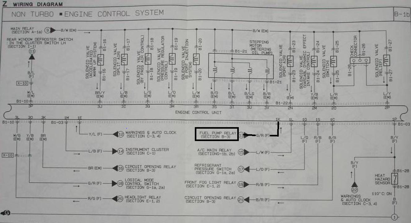

Originally Posted by Barnahadnagy
Fuel pump will run with the key in START, regardless of MAF input, so with the MAF unplugged it should start then stall out.
Intresting, when I wired my car for Megasquirt, the power for the fuel pump ran though the air flow meter, so it can not send any power to it until there is airflow, as there is a physical switch that closes when it it just barley opens. How is your car wired differently?
If you have any pressure to start and stall out, it is due to gas tank vapors expanding at that point
Old May 9, 2022 | 01:57 PM
Barnahadnagy's Avatar
Joined: Sep 2018
Posts: 106
Likes: 15
From: Hungary
Wired stock . S4 FSM, 4B-76, Turbo Emissions Control, Circuit Opening Relay (same for NA as well). Ignition in START has exactly the same effect as signal from MAF, the fuel pump will run. This signal comes from the ECU, it also energizes the subzero start assist (that grounds through the oil-pan thermo switch, when cold enough).
Old May 9, 2022 | 03:05 PM
FührerTüner's Avatar
Penis Healthy
Joined: Jul 2013
Posts: 2,596
Likes: 799
From: █▬█ █▄█ █▬█ █▄██▬█ █▄█ █▬█ █▄█
