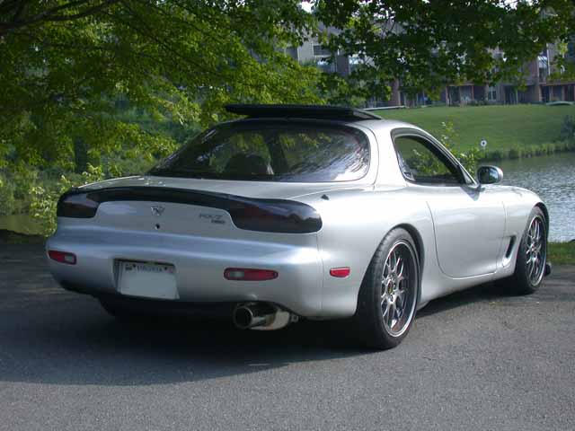

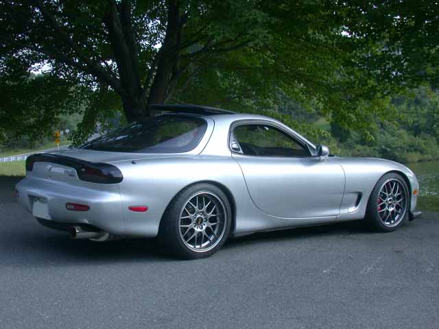

Found the pics of your RG-R's....nice!
Attached Thumbnails BBS RG-R 17" preferred size?-dscn2062.jpg   BBS RG-R 17" preferred size?-dscn2064.jpg
