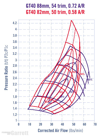

Acually, 15 split is ok for this setup with running more boost in mind. Yes this is what the plan is. About 15psi is going to be sweet on this ride. Paul Yaw is the one who trained me and I think i will suggest this to my customers with confidence in my abilty and Pauls overwelming knowlage. Tuning is something you learn over time and I think Darkslide is doing a great job not ever touching a rotary car before this one.
Gt40 comp map for you Darkslide

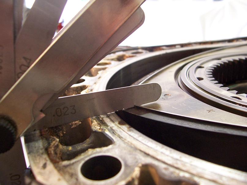

One of the smallest problems is pictured.
Attached Thumbnails T4/Gt40 10psi dyno results FD- 327hp-.023-sideseal-clearance.jpg

Nice. Good Lord, people some are stupid. Although I just rebuild a renesis engine with 30thou gap from side to corner seal. Pretty bad, when it is from the factory....
