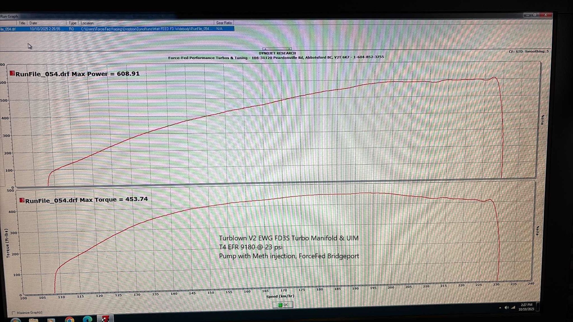

T4 EFR 9180 on our new V2 EWG FD Rx7 Turbo Manifold
a
Pump gas only dyno above ( 15 psi)
Pump gas with Meth injection below ( 23 psi )
Here is the engine bay, Marko from ForceFed who did the install/tune called and mentioned they had an almost identical car on the dyno with our V1 manifold & OEM UIM, and this car made 50+ rwhp over that one. Just an interesting tid bit.
