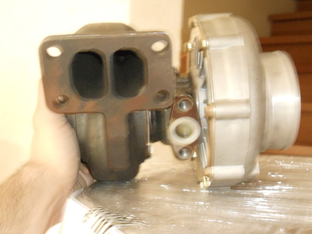

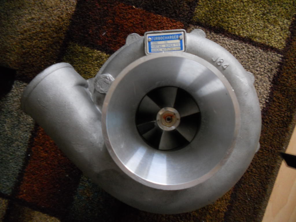

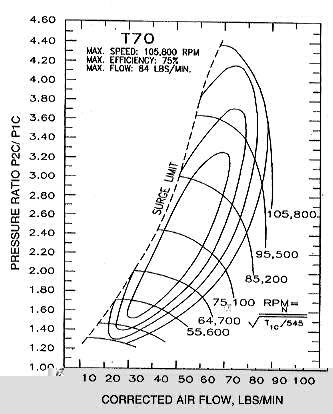

Anyone ever heard or seen this turbo being run on a 13B? Im gonna do a T2 swap on my first gen and Im wondering if its even worth trying it. From what i could dig up it is an ebay turbo but it was given to me for free so...and it is brand new.

Well it looks like the hot side A/R of .84 would work but it is a T3. Searching around the interwebs led me to XSpower and SS autochrome......yep a shiny spinning paper weight.

Seen a few disintegrate and blow engines.. Its also not a T70 wheel, more like a T60 wheel..

That's a T4 flange too. There is no such thing as a T3/4 flange. It's either one or the other.
Should work decently well until it falls apart.

Found the info here, http://xs-power.com/turbos-2.htm it says T3/T4 flange?????

The 2nd pic on the first post is from their website and looks like its a T4, this looks like T3 to me...more rectangular than the squareish T4.

It can't be both. It's either T3 or T4. Measure it, only way to know for sure.

I would be hesitant to run a turbocharger with a little name plate that says "turbocharger" on it.
It's a T3 flange and as Turblown mentioned looks smaller than an actual T70.

Its not a 'T70' as in 70mm indiucer, it's a 60.5mm inducer, much smaller.
That looks like a T3 flange to me too.
