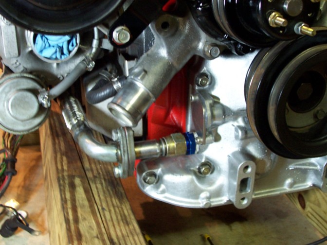

Just for grins, here's my turbo drain on an S4 engine with S3 front cover.

Got me grinning - nice line. Exhaust manifold changes up everything and determines the fittings to be used....
