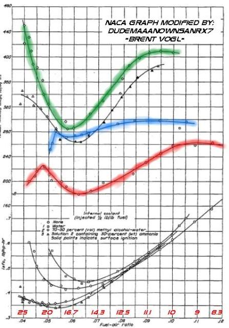

Not to take anything away from alcohol, it does have significant cooling abilities to the air temps, but those planes would be flying so high that keeping the air temps down probably wasn't too much of an issue. I was also reading some articles on WI in the WW planes and the meth used for antifreeze was reduced and even eliminated on lower altitude missions. Other WI systems were used only for take off in certain aircrafts. It is really quite impressive the crude technology they had at the time and how well they made it work. I found a website that had a table/graph that listed and compared the effects of water, methanol, 50/50, and straight gasoline at different AFR's (actually FAR) and boost levels. If i can find it again i'll post it up.
Okay I found the Graphs. They are from a study NACA (previous name for NASA) did on water injection awhile ago.
x axis = Fuel/Air ratio (I took the liberty of converting it to AIR/FUEL in red. EXAMPLE:.08 =12.5:1)
y axis = Break Mean Effective Pressure (basically torque or power output)
Each colored line represents a different mixture tested:
Green = 70/30 Methanol/Water
Blue = Water only
Red = No Aux injection used
They injected 60% as much of the Aux Injection as they did fuel. The engine is fed pre-compressed air from a controlled source. The coolant temp is fixed, the compression ratio is 7:1, The different mixtures were injected just prior to the inlet valve. The first graph is with a controlled 250* F inlet temperature similar to a non intercooled engine, the second graph has an inlet temperature of 150* F which would be more like an intercooled engine.
Blue = Water only
