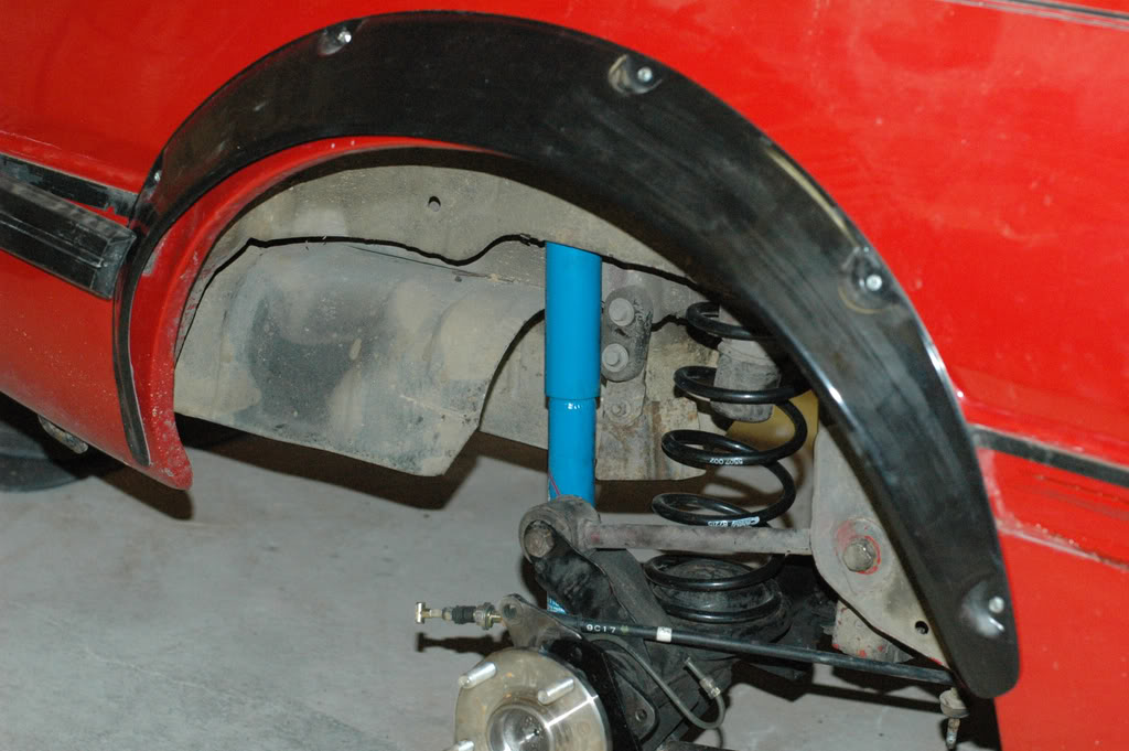

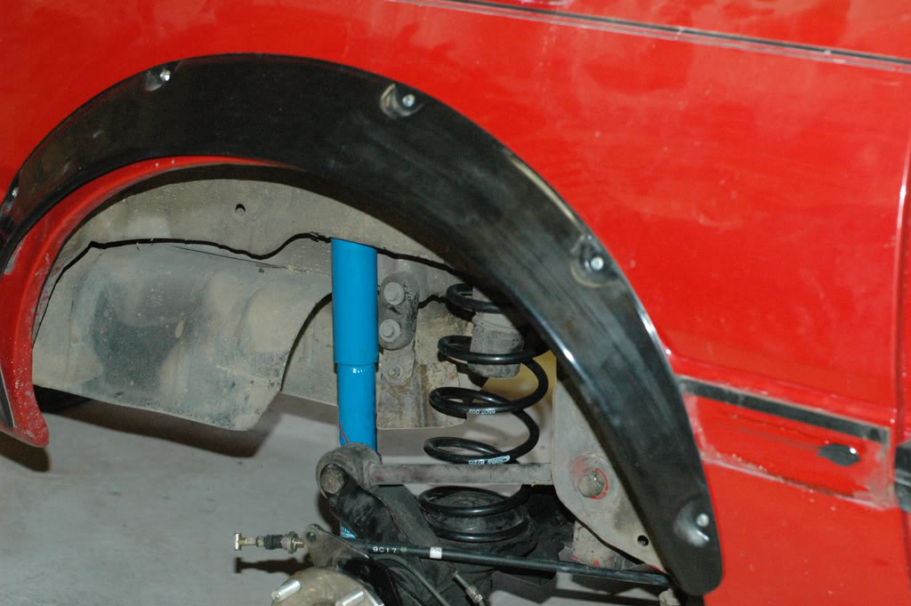

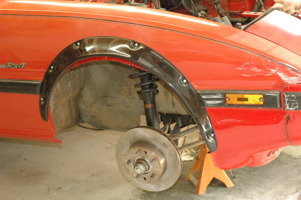

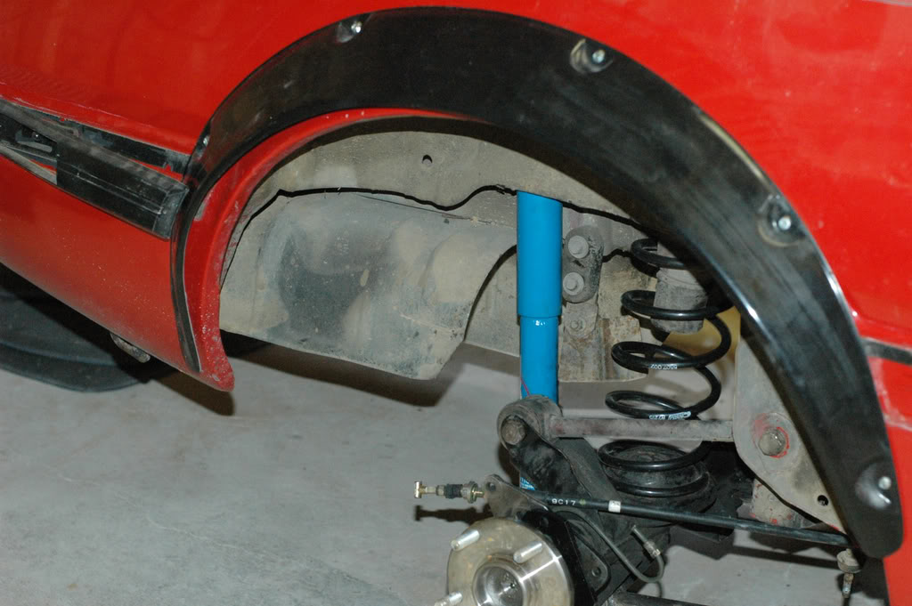

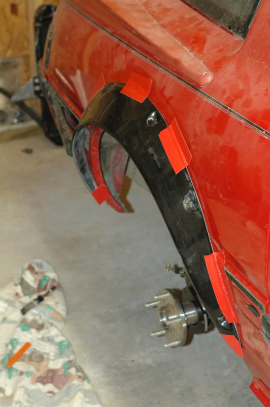

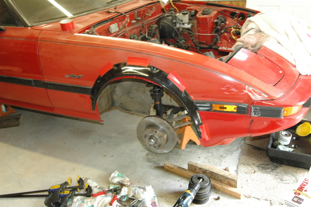

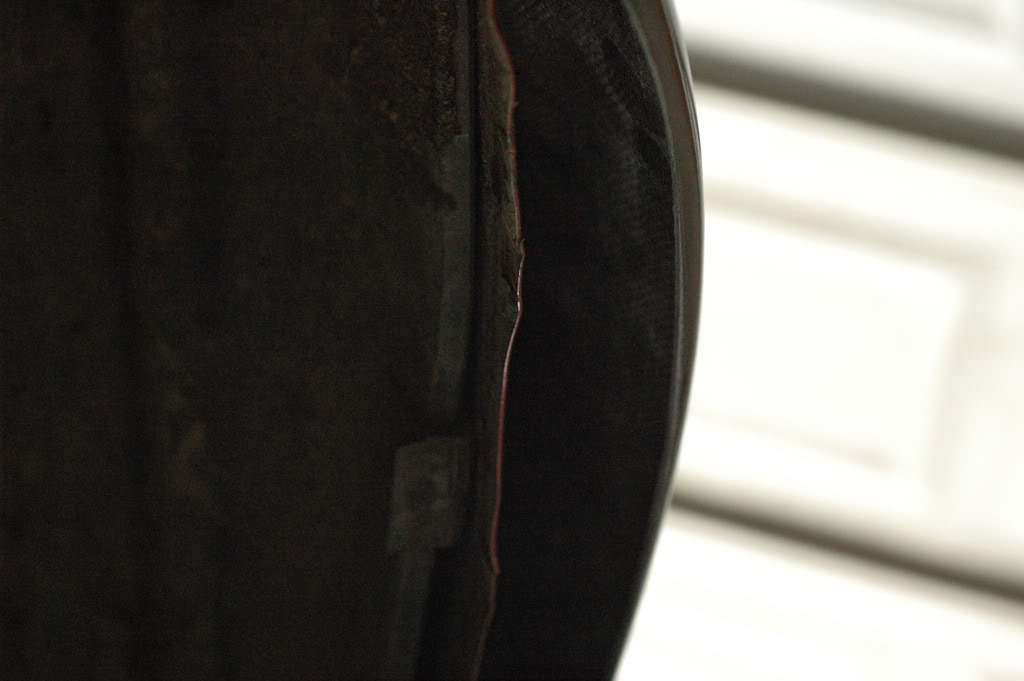

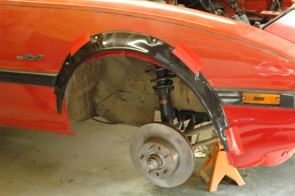

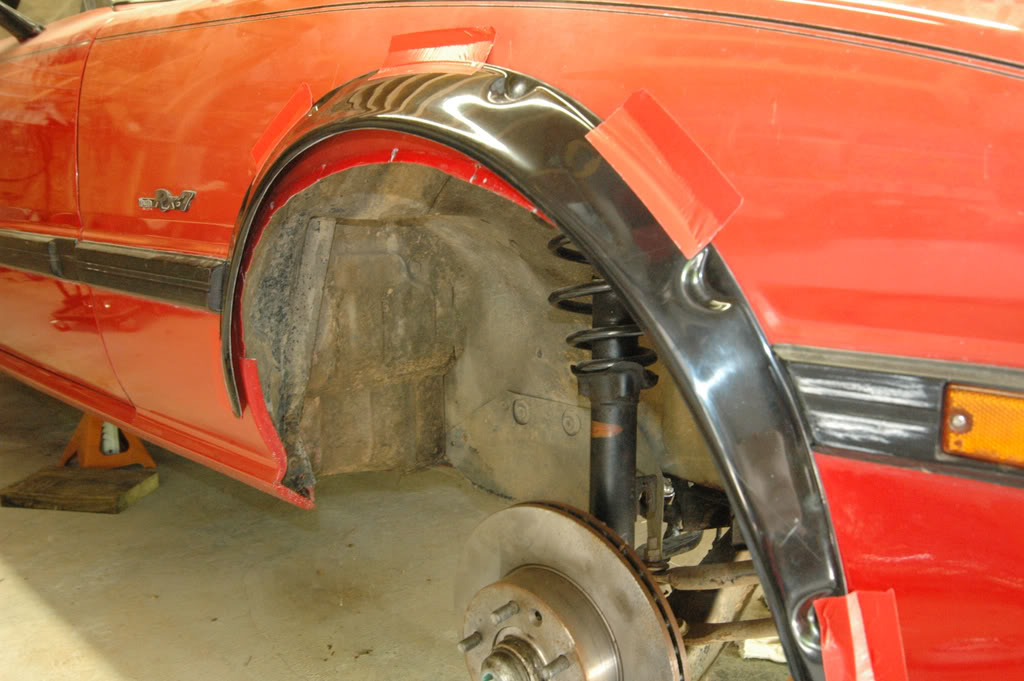

I know you all have probably forgotten me as another one of those guys that doesn't follow-through...well, school became more demanding and whatever, you have heard all that before I'm sure.
This weekend I finally got time to tackle the flares. I had imagined a science for approaching putting them on the car but I really think it's completely up to the imagination as to how to mount them and what looks acceptable to you.
I worked the fenders flat, pulling the existing fender lip straight. I'm going to cut all of this off but since you can easily take metal away but it's very difficult to add it back, I thought this would be the best approach. I took one of the ZG flares and tried to match it up as best I could and taping it into place. If you are worried about your paint, invest in some 3M tape that's designed NOT to take paint off. Be smart. Here's the mock-up:
After I was satisfied with how the flare looked, I drilled through the flare and body and then secured the flare using some temporary screws. I'm going to find some better hardware for the final fit, but in all honestly, looks are not what my car is designed for...I'd rather look inconspicuous (I know, why get flares, right? Well I have to put the power to the ground somehow...). At any rate, here's what it looked like after securing the flare with those screws:

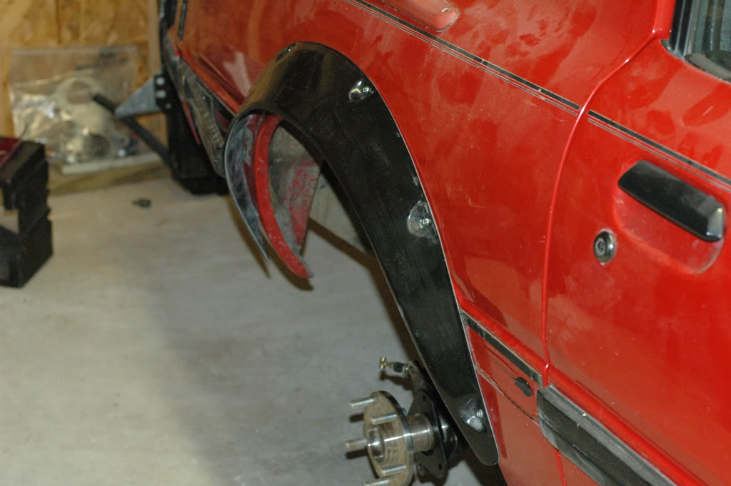

Now the rear became a bit more complicated. My car is a GS and has trim all around the exterior. This became a problem as the ZG rears would not fit (conform to the body) and also fit between the pieces of trim around the fender. I used a flathead and pulled back both trim pieces which are secured by glue. I'm not sure what I'm going to do with the trim, but I ended up taking off the piece in front of the fender and just letting the rear trim hang loose because it's REALLY attached to the car:

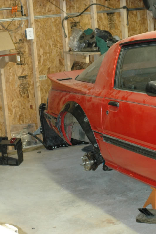

Any suggestions as to what I should do are welcome. I mocked up the rear much like the front:
After I was satisfied, I drilled some holes and secured it with screws:
The most difficult part has been making the left and right sides match with respect to distances. I originally used the pinstripe as a guide...that's a BAD idea. The pinstripes are hardly identical. Make your best guess for a "good" measurement and eyeball the height using a rolling stool or get on your knees a good distance from the front of the car. I know, an incredible amount of science, but as I've state it's not really a matter of science!

I think they look pretty good but I still have some work to do. The plan is to cut away the existing fender as much as possible and also put a layer of 3M automotive acrylic tape between the flares and the body. Here are some additional shots (don't mind the dust!):

To give you an idea of how much clearance you'll gain, here's a shot of the inside front fender. The spacing in the back is at least as wide as the front:

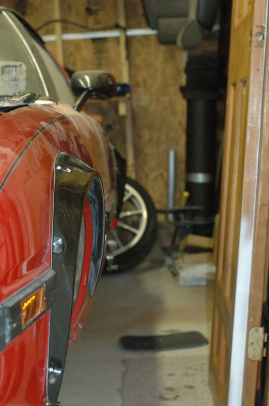

nice. ill be watching you closely. i need flares and thie may be the route i go.
how flush are they with the body? are you going to use double sided tape between the fenders and body? ive never heard of acrylic tape.
you gained about what, 2"? did you try heating the tips to try to get them to conform to the body better?
the rears look great. the fronts look...odd or something. maybe its just the pics.

I agree on how the front looks weird with the front of the flare extending down past where the rear of the flare ends.
If you could get some skirts for the side with a little bit that comes up to meet the flares then massaged the flares and the skirt together it would look real complete

Could it be that I have the fronts backwards? There's a distinct bubble in the flares and I tried to put that towards the rear on all of them...if that makes sense. There's really no way to tell which way is forward. I will take some more pictures when I get a chance. The rears are the ones that are the most difficult to match up to the body hence me removing the trim pieces. If you wanted the flare to fit in between those pieces it would bubble out from the body a good bit. I didn't try heat.
I'd say it's about 2". I'll put a tape measure up there for the pics.
The tape I have is 3M acrylic double-sided tape and it was recommended to me by a painter/body work individual that offered to do these for me. I decided to try it myself.
