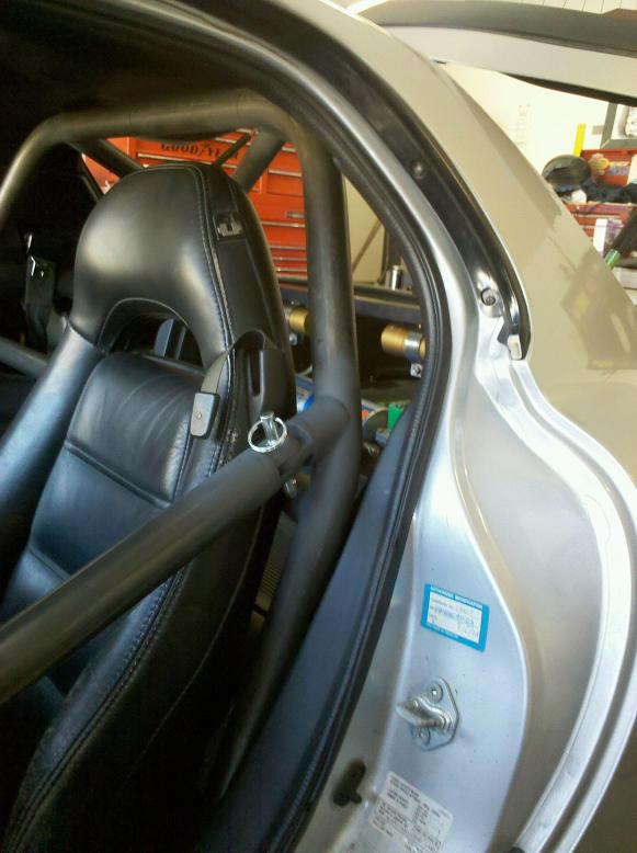

I was doing measurements with the dimensions of this seat and the dimensions inside the FD, and from what I've seen, the seat will fit with slight trimming at the wing.
Unfortunately, I have door bars in my FD, so I would have to cut off close to the entire wing (2-3") in order to get this seat to fit. I'm going to measure for that tomorrow. If I can get away with less than 2" of cutting on the wing, I'm going to purchase one to see how it fits. As far as getting a seat with wings, I'm SOL, unless I trim:
Does anyone else have door bars with aftermarket seats? Someone with a Raceshop 6 point will have the same/similar height as I do - anyone?
If someone would be so kind and give me the stock seat dimensions, I could come a little closer to seeing if this seat fits. A picture with dimensions similar to this:
