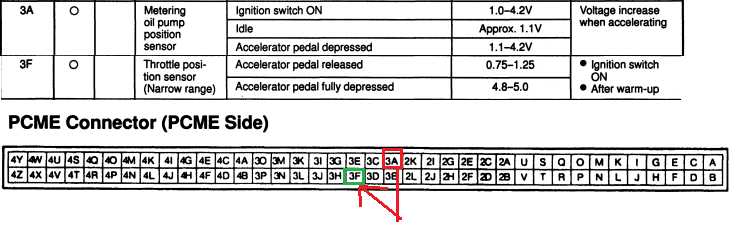

For a simple solution, what if you just spliced the OMP position sensor wire into say one of the TPS wires? then the voltage would never be out of range. So splice the wire on pin 3A (the OMP sensor input wire) to pin 3F (narrow range TPS signal) or pin 3G (full range TPS). Assuming the VOMP is highlighted for the same reason as every other sensor, using a good TPS signal for it should not cause a fault condition. Here's a crude MS paint diagram:
The VMOP and the VTA2 signals should be about the same now. All you're trying to do is make the CEL go off without a whole lot of hassle, and this should work if the PFC is as dumb as I think it is...
The same type of thing could be done if you remove your fuel temp sensor due to an aftermarket fuel rail. That would highlight the fuel temp sensor in the sensor screen of the commander, theoretically triggering a CEL on a JDM car. The fuel thermosensor wire is pin 1U. You could tap that into the water temperature sensor signal which is pin 3D. The two sensors are very similar anyway.
Attached Thumbnails Chance to disable the OMP over PFC/Datalogit...?-omp_sensor.png

Great Idea - better than applying the five volts. The two temp sensors are interchangeable. The higher water temperature signal if used for fuel temperature will trigger the speed relay however.

Just got round to doing this, and it works!!! no more OMP warning light.
Bridge 3A with 3F
Arghx - you sir, are a star!!
