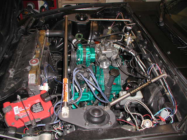

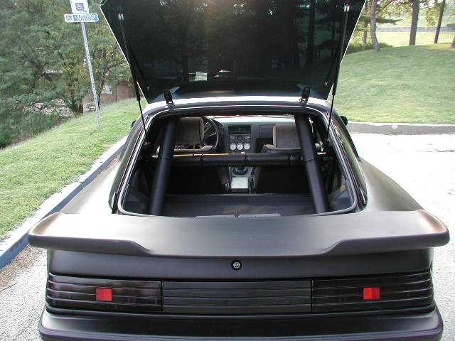

Well, here it is. The car went in the shop last Thanksgiving weekend, and I have been at it most every day since then. I thought it would take me 2-3 months to do the restoration, rehab and rebuild. Man was I wrong.
A brief description of the work performed:
Unibody stripped down to the chassis. The ONLY things not removed from the car were the wiring harnesses and the dash. Everything else came off the car!!!
Body and under carriage stripped bare by sanding or sandblasting.
Minimal rust repair needed.
Body was epoxy coated and the undercarriage was then coated with truck-bed liner. All seams were caulked prior to undercoat.
Epoxy was then followed by a polyurethane primer and single stage polyurethane topcoat in matte black.
All 4 fenders and air dam are fiberglass, as is the wing. Rear fenders are bonded to the body. I had to trim out and reweld the original rear fenders and liners to increase height clearance for the wheels. Even though they are a slightly smaller diameter than stock.
Body kit is from CP Racing. Wing is the Mariah whale tail. Front bumper is the stock sub-bumper modified and glassed to fit the kit. The kit was designed for the SA's.
Power steering added due to width of front tires. A/C removed. FC front mount oil cooler added.
Every suspension piece replaced, except the idler arm, lower control arms and rear links. If it was a wear item, it is new. All new poly bushings, solid motor mounts are on the way. This also includes the brakes. GSL rear end added along with Brembo slotted discs in the front and ss brake lines all around. Epsilon 3 piece wheels with 225/50/15 T/A’s in front and 245/50/15 rear. Eibach’s, Illumina’s and ST front and rear sway bars.
Motor is a fresh rebuild with 1/2 bp secondaries, large street port primaries and large ported exhaust. I have a thread on that titled '12a builders and porters wanted'. Engine, and everything else that could take the heat, is powdercoated.
8 point roll bar, with hinged door bars, fully padded.
I have tried to keep as much of the stock interior as possible. I still need to make new door panels and bin covers due to the cage. The body was originally a GS without a sunroof. A po installed an aftermarket sunroof, but not the headliner. That was a pita to install properly.
Autometer gauges for: boost/vac (boost is this winters project), oil pressure, temp, volts and fuel. The 4 redundant gauges in the cluster were removed and filled. Added gauges are on their own separate dimmer switch.
GSL-SE fuel tank with new 3/8” aluminum supply and return fuel lines. Mallory comp 140 fuel pump (a bit too big) and return style regulator. Mikuni 44 PHH for the breakin period. Holley 650 dp, waiting on the shelf.
5% tint on the hatch and quarter glass, 35% on the door glass. Those are the limits here, I would like the doors darker.
Now a little rant about courtesy and decorum. There are 2 things in this entire rebuild that I haven’t done myself. I didn’t set the fixed glass or tint the windows. Everything else was done by these 2 little hands now on the keyboard. If you don’t like the choices I’ve made as far as the kit, the wing, the paint, whatever, at least show some respect for the work it has taken to get the car this far. If you don’t have anything nice to say, STFU. Just in case some of the younger members want to say ‘ricer’, the kit, the wing and the wheels go back more than 20 years. The wheels were made in 85, the wing came off of an ’82 found in a junk yard and the kit is a knock-off of the old Pacific style kit.
Rant over.
Enjoy the pics.

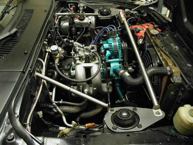

More pics.

The front end looks tall because the lip is about 4" off the ground, and the car is lowered, of course.
Re-read my post on the work.
I thinking on megasquirt and turbo this winter. Still need to break in the engine and then tune the Holley to see how it runs. If I start heading past 250 hp later, I have TII tranny waiting.

Where did you get the strut tower bar set-up from?
