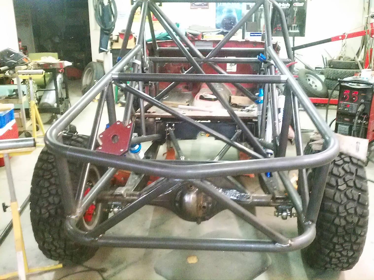

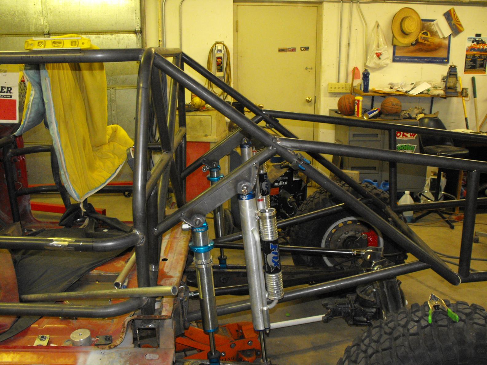

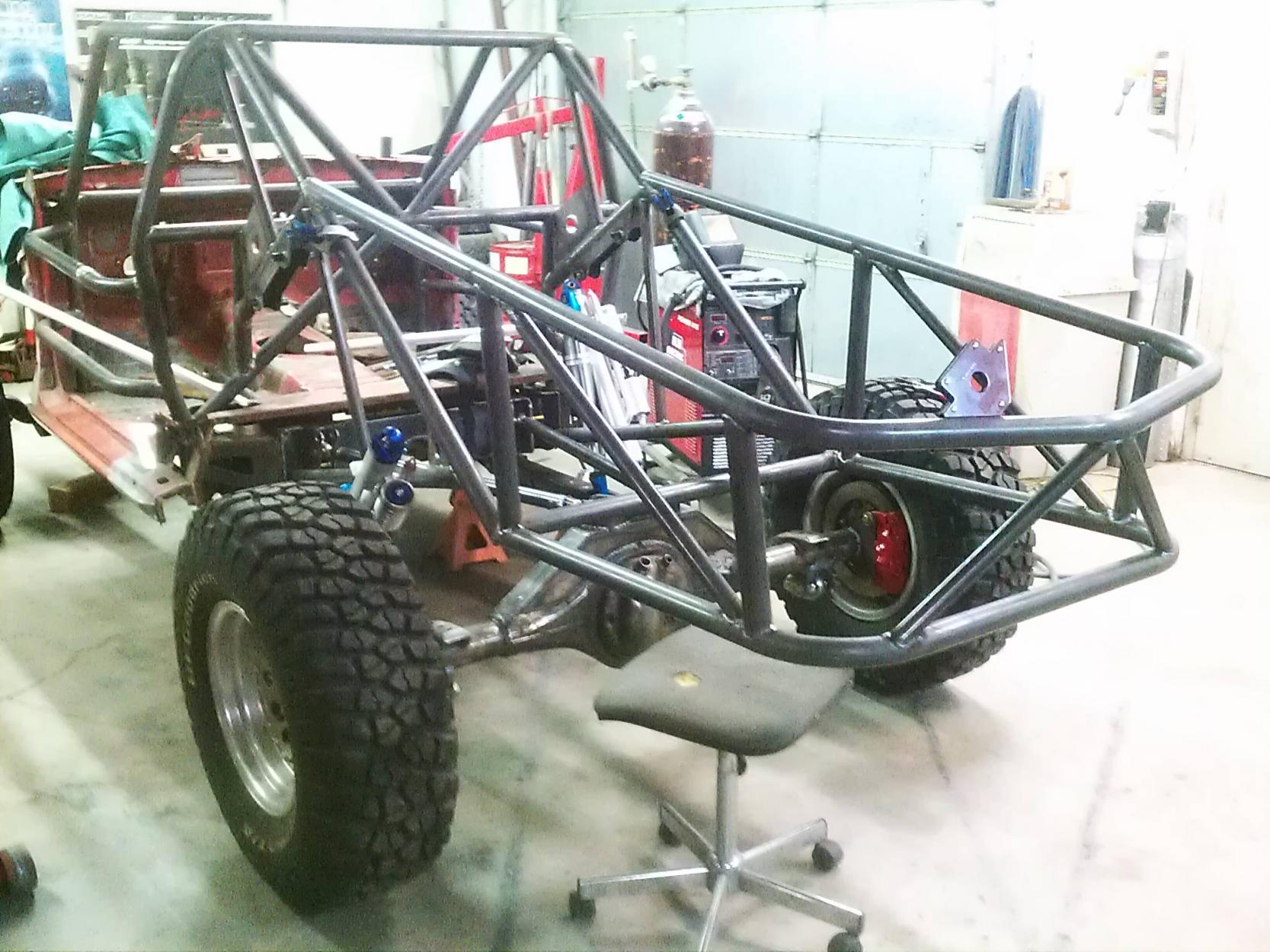

Have a unique project underway. Well, for THIS site anyhow. It's a LUCAS Mini Open short course truck. It's getting a 13B Peripheral port, to be bodied as a B2500. Mostly tube framed with big travel and lighter weight. Rod Millen actually had great success racing one of these engines off road.
So, the question is that I have a 1991 T2 manual trans behind it now. Was bulletproof when we road raced it and the ratios were good. So what kind of abuse will this thing really take?
Attached Thumbnails T2 Manual Trans q's-imag0571.jpg   T2 Manual Trans q's-dscf1006.jpg   T2 Manual Trans q's-imag0572.jpg
