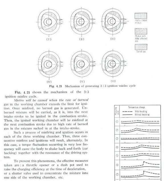

The bucking is because it's a rotary. All rotaries will buck like that at sufficiently high manifold vacuum. With a stock port, you can only get enough vacuum to buck when you're coasting in gear with the throttle closed. Additional overlap makes the bucking occur at lower and lower amounts of manifold vacuum until finally it occurs in the range where the engine is normally at during an idle. (brap brap brap...)
The shutter valve is there to combat the bucking, by shutting off half the carb and injecting a ton of air into the intake manifold, which reduces vacuum without increasing power. A stock pre-81 car will buck. A stock 81-up car will not buck, assuming all is working properly. (Mine doesn't buck, and everything is there and functional)

It's the infamous 3:3 misfire. See attached.

Wow...
I've calculated this misfire rate before, by calculating the frequency of brapping at a 1500rpm idle and then working backwards to see how many cycles "hit" and how many "miss".
You can use this to figure how fast an engine is idling, just by sound... it sounds really weird at 600rpm
