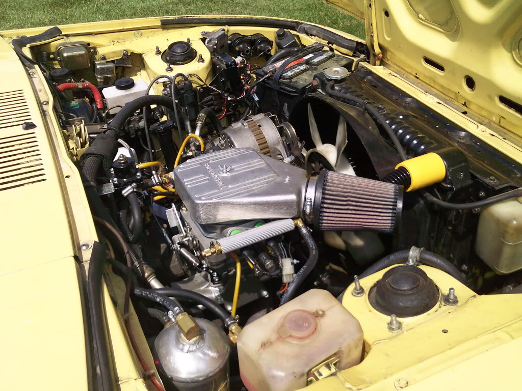

Im currently doing a fuel injection setup on my 12A. Im using the megasquirt 2 ecu. and Autonomics 4 barrel throttle body. http://www.auto-nomics.com/cgi-bin/s...part=12168-001 I just received the throttle body which is the last big part. Im looking around now for the right fuel injectors as they use the EV1 style injectors which are the older style.
Old Mar 10, 2011 | 04:50 PM
RXDad's Avatar
Posts: 304
From: Newark, DE
Been there. I used 42 lb/min Ford Racing green tops.
RXDad
Thats the Auto-Nomics TB. What did you pay for that? The MSII is way better for rotary than a microtech. Ken has tuned the MS2extra code very well for the rotary.
i pay 380 for the TB and from what i seen most of the faster rotary from P.R , AUstralia and the U.S use the microtech.
