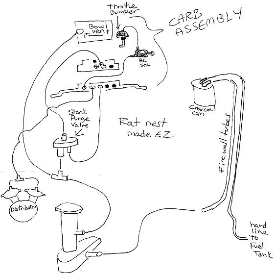

After doing the "rat nest removal" I realized I'm applying vac to the distrib all the time. (advancing timing) With the rat nest removal at idle there was no vac to the distrib.
I like the way the exhaust sounds with no vac. It's more of a deep pinging throaty note, but the idle seems less stable at low rpm like this. I could easily hook up a solenoid to return the car to the factory no vac idle setting. Just wondering why mazda decided this was beneficial?
You have the vacuum advance line running to the wrong nipple on the carb base. Some of them always provide vacuum, and some only when on the throttle. I believe either of the two on the far right will get you where you need to be.
Your saying not like this.....
But like this.....
Right. You don't want the vac advance running at idle, because then you'll never get it to idle correctly. Also, if you set it up that way, you won't get proper advance when you do need it.
Just going by memory, I think there are five nipples on the base of the carb. Check each one for vacuum at idle, and use one that doesn't have any. I believe either of the two on the far right will work for this. I had this problem for a long time before I read this information and got it corrected. Setting idle speed and mixture is much easier once this is corrected. Idle should also be a lot smoother too. Good luck.

the timing is setup like it is, because they had to pass smog, and the distributor is a little limited. dizzy can adjust the timing like 20-25 degrees, the FC efi does 48 + whatever retards it needs
if you dont have emissions, the idle timing can just be set to where it idles the best

hmm... I've got mine connected on the second spot, like in the first diagram. How do you know which of those nipples gives vacuum when? I mean I guess a vacuum gauge could tell you vacuum at idle, but how do you get a vacuum reading under load?

I wanted to chime in here and say that I had mine set up wrong. I connected it up right and it runs quite a bit better now.

which nipple do you have yours hooked up to now? the way of the first diagram or like the red line? if the first diagram that was posted in incorrect, then a lot of forum members have theres hooked up in the wrong location. if it is wrong, then there needs to be changes made in the archieve about removing the rats nest.
There is so much mis-information in this thread it isn't funny.
#1 Advancing Timing Causes cooler engine temperature, especially when you are talking about at idle.
#2 The Correct Vacuum nipples do not have vacuum present on them when you are off the throttle in an attempt to keep the idle timing more correct, but still allow for advanced timing under cruising conditions.
#3 The stock distributor does not advance anywhere near 20-25 Degrees. The Distributor will advance by around 13 Degrees from idlish rpm to 2500 or something (I read this in the FSM btw, no making this up). Vacuum advance is sweet **** all anyway, about 3 Degrees on the leading if I remember correctly. Trailing vacuum advance is much more than leading, somewhere in the realm of about 10-15 degrees if I remember correctly. Firing the Plugs very close together under higher rpm and vacuum conditions is a good thing to do.
T2 models with stock ECU's actually fire the trailing plugs before the leading plugs when they are given high enough rpm and a strong enough vacuum.
#4 Correct timing for power WILL make your car idle shithouse, How do I know this, I payed someone to tune my car, realised that 24-28 BTDC at full rpm, means when you subtract about 13 degrees off, between 11 and 15 BTDC at idle, ie way too much timing. I installed computer controlled timing and now I have full range, my timing can vary from 0 to 40 whereever I want it to.

Advancing timing to a degree does make the engine run cooler. But max out your distrib full advance and let it idle and the engine will over heat.
I'm not saying the vac source going to the distrib will cause over heating. But I couldn't think of any other reason.
So I guess the answer is the car is suppose to idle better with out vac. And The vac advance is just for better gas mileage at cruise.
It didn't make sense to me because my car idles better (smoother and lower rpm) with vac constantly going to the distrib. The whole purpose of the thread was to try and find out why mazda thought it was necessary to take out timing at idle.
So the only other thing I could think of was heat issues? (which as you pointed out is probably wrong. )
Appreciate the correct info!
Red line.

I swapped the lines out today. I really don't notice any driveability changes. I'll keep an eye on gas mileage but as stated above I think it was an emissions deal. So I'd try it both ways and see which your car idles the best. Mine hands down is smoother with a constant VAC source.
Mazda probably wanted the retarded timing at idle for the hotter more complete burn of fuel for emissions testing purposes.
