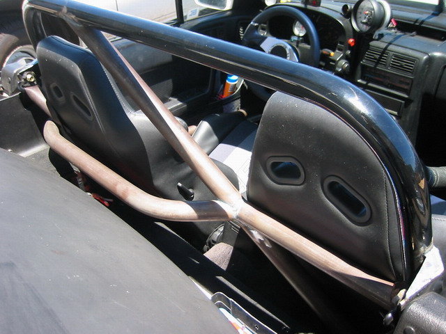

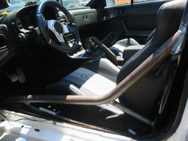

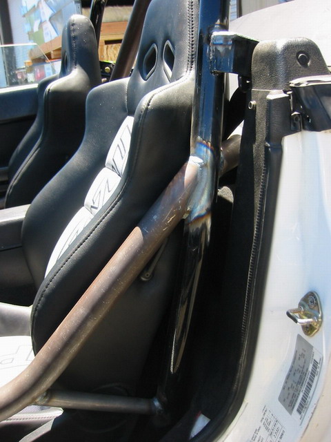

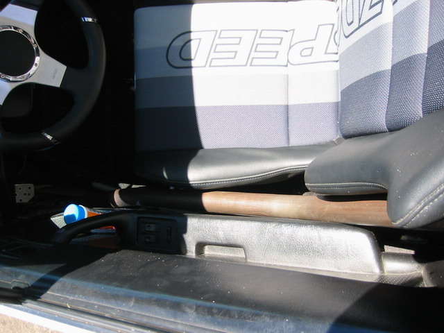

Custom vert rollbar
Allows normal operation of the top with the fitmment of racing harnesses on the new harness bar.
The main hoop bolts to the floor behind the seat and again at the top of the b-pillar at the seatbelt (shoulder) attachment point just as it did originally from Kirk Racing.
The new door bars are welded to platforms on the door sill.
You can tell where the new tubing was installed. Diagonal bracing, harness bars, door bars w/ braces, gusseting at the tabs where it bolts to the b-pillar. All welds have been TIG-welded.

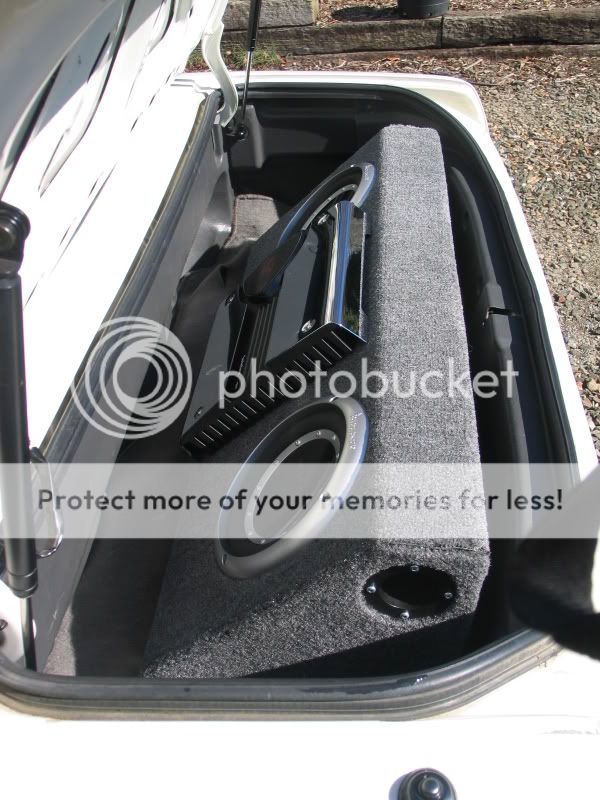

No, the only speakers I have are the door woofers, the ones in the lower part of the dash, and the headrest. I custom built a sub box with 2 8” rf p1 punch series and mounted a p3001 amp on it as well and put it in the trunk. Due to the very limited space as you know. I have never seen a vert with wookers.
here is the box i made up, it may look like it is sticking out but it just about sits flush.

No offence, but isn't that bar too close to your heads?
Not at all. It looks like there is not enough in the pics but there is plenty, believe me. The seat is also all the way back which is not where I have it positioned when driving.
I don't want my head banging off the bar anymore than I want it grinding and banging along asphalt.

Nice box. So much for wekend trips though. At least you can take it out though...but then you have no tunes
The speakers behind the seats are OEM. Perhaps an upgraded stereo option or only available on S5 verts. Icemark would be the man to answer that. I have a sub right behind my seat under the spare tire cover as can be seen in the pics from my sig.Additionally, there are two amps and my battery under there. No spare tire anymore. Also, the spare tire cover has 4 - 5" speakers installed on the leading edge.

From: Greensboro, NC
are you going to put padding on this roll bar? looks nice, and it's always good to be safe! anyhow is it much harder getting in and out? it seems to protrude into the entry way very little, another + verts are awesome, if I had one, i'd get a roll bar too, cause you never know exactly what will happen while driving.

I'll run padding when on the track. Daily driving I will not have any since my head isn't really any where near the bar.
Getting in and out is almost the same as it was. Have to extend the leg a bit more but not that much. The bar bend at the hip actually makes it a bit easier sinc3e it acts like a handhold. Once in the car you don't even know the bars are there except when looking in the rear view mirror.
Technically this a rollbar not a rollcage.
