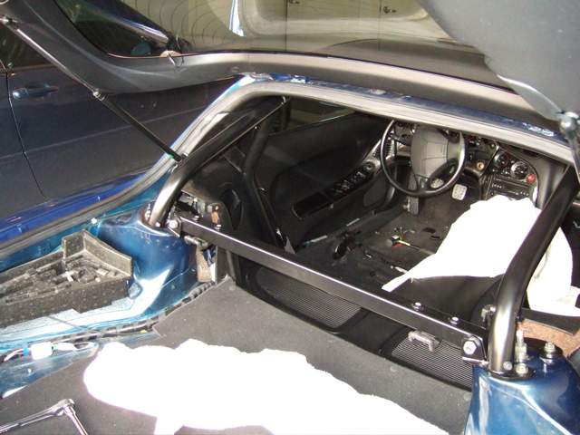

I don't have the bar totally installed but I wanted to fit it in (without tightening the bolts) to be able to accurately drill the holes to mount it to the floor boards.
Just some tips:
1) when installing the harness bar, the bolts can only go one way or it interferes with bolts from the bar. That is to remove the bolts later.
2) mount the connecting bars from the harness bar to the main hoop first before attaching the main hoop.
3) cut the holes for the plastic covers that go over the strut towers and mount them BEFORE you finally attach all the bars in place.
4) you have to cut the carpet for the floor attachments.

Some test fitting. The bolt clearance that was reported before is no longer an issue. VERY EASY to get the bolts on the harness bar plate:
Test fit:
This is why you test fit You need to cut the carpet otherwise it too tight:
Attached Thumbnails Raceshop Street Rollbar preinstall pics-dscf0102.jpg   Raceshop Street Rollbar preinstall pics-dscf0101.jpg   Raceshop Street Rollbar preinstall pics-dscf0100.jpg   Raceshop Street Rollbar preinstall pics-dscf0099.jpg   Raceshop Street Rollbar preinstall pics-dscf0098.jpg
Old Feb 5, 2006 | 11:34 AM
7racer's Avatar
Posts: 3,736
From: Dallas, Texas
I can't get the main hoop to attach to the attachement bars due to the carpet:
Attached Thumbnails Raceshop Street Rollbar preinstall pics-dscf0096.jpg   Raceshop Street Rollbar preinstall pics-dscf0097.jpg

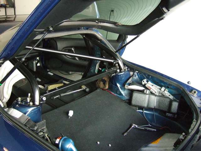

Here are some more pics and tips.
I pulled the side plastics off to turn the carpet over. You don't have to do this as you can slide the carpet out from the side plastic runners and unbolt the rear bins to lift the carpet out. My car is half apart anyways, so it was easy for me to remove the piece.
I tested fitted every part. Didn't fully tighten the bolts down for the harness bar plates until I got all of the bolts into place.
It's wierd how things vary from one car to the next. The passenger side part of the bar just clicked into place. I then EASILY slide the bolts into place and WOOT! I thought I was home free! The drivers side was a PITA. I couldn't get the bolt that attaches the main hoop to the connecting bar to the harness bar in. What I ended up doing was taking off the harness bar. Left the plate and connecting tube together and then bolted it to the main hoop. This left the plate hanging in the air above the strut bolts more toward the center of the car. This part was then easy. I just grabbed the whole assembly and pulled it until it was over the strut bolts and "popped" it down and in.
Now I just have to drill the holes for the floor plate and cut the carpet. I think I am going to do it like maxcooper by cutting a slit to let the carpet go around and then cut a hole to let the bar through.
I can already tell this is probably going to increase the road noise in my car...especially considering I have pillow ***** on the coilovers....
Here it is with it fitted and all bolts in except the floor board bolts.
Note the rear diagonal. THIS THING IS NICE
see got it all nice and aligned and bolted up:
here is where the foot plates of the main hoop end up. You can drill three holes from the top. But will have to get the third from the bottom or after you've moved the hoop back out of the way.

Just some more tips for the install.
I followed maxcoopers write up on drilling the holes for the floor plates. I drilled all three holes from the top. Then placed the two bolts where my fingers are pointing, and tighten the bolt with the outside plate to the two bolts.
You will find the third bolt doesn't quiet line up anymore....I just then enlarged the hole to get the third bolt to fit and tightened that one down.
Once that is done, I jacked the rear end up and drilled the final hole from the bottom up. As max said, it aligns and hits the final hole each time! SWEET! **GOOD TIP MAX!
Now you can see all four bolts thru the bottom plate:
Maxcooper also commented how the bolts hung down low....I may run to the hardware store to see if there are some shorted bolts...maybe 1 1/2 "
