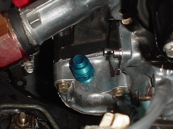

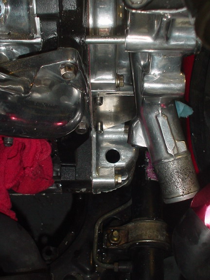

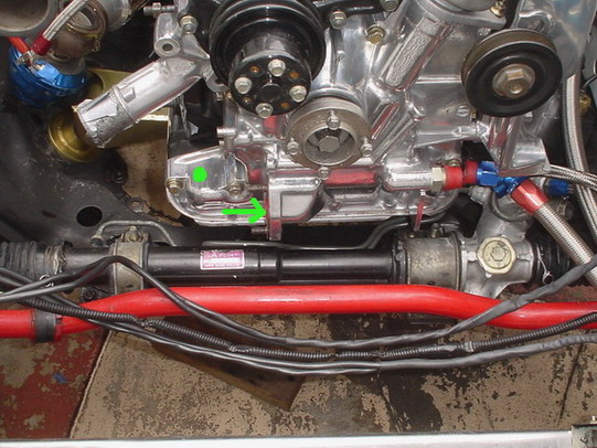

Well I got around to installing the breather line in the front cover today. It came out pretty good...hopefully it works.
Here is where I drilled the hole for the 1/2" npt to -10 an fitting. This is obviously a 2nd gen front cover and I have the mop blocked off since I use pre-mix. I'm pretty sure it would work with the mop installe too. This location does not interfere with the turbo drain line or anything else for that matter.
The casting of the front cover is just thick enough to get some threads into it from a tap for the npt/an adapter.

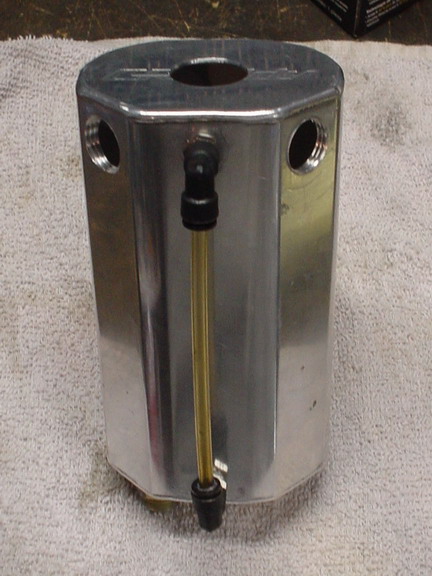

Here is my modified GReddy oil catch can. I enlarged the two side openongs towards the top for 1/2" npt and 3/8" npt to -an adapter fittings. On the top is a large K&N breather. On the bottom of the catch can is a quick drain fitting.

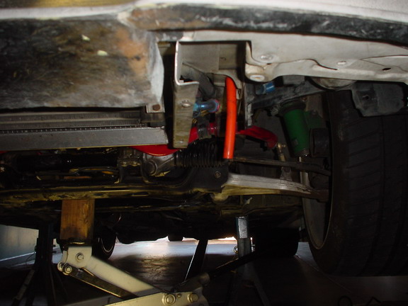

The hose attachment for the quick drain fitting is permanently located in the frame rail and protrudes out the bottom for quick and easy draining. Here you can see the top of the hose and its screw on fitting. Of course I unscrew the hose so the catch can is sealed when driving about and drain it between sessions.
Here you can see where the orange hose from the quick drain protrudes through the rail out the bottom of the car.
Originally Posted by RX-Heven
Here you can see it all installed. There is also a -8an line coming out the top of the oil filler cap that goes to the oil catch can that I had previously installed.
I thought of teeing into the turbo oil return line as some others have suggested but decided against it. The reurn line is obviously used for returning oil so in turn the line will contain oil...duh. These lines are not under any pressure, or should not be in any case, otherwise you will be pushing oil past the seals in the turbo. Because the line is not supposed to be under pressure, it might work but I wanted something I can be sure of. The return line sees the same pressure as the inside of the oil pan. I figured the necessary venting would just push some of the oil that is always present in the return line into the oil catch can since it's role would become dual purpose if t'eed into. T'eeing into the drain line may also hinder the lines abilty to properly drain oil from the turbo as the vented air is pushing in the opposite direction the oil needs to be draining in.
In the end, it would probably help, i cannot see how it wouldn't. However, I want to eliminate the problem of pushing oil into the catch can, not just reduce it.
I will report on the results in late January after Laguna Seca
