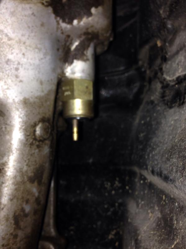

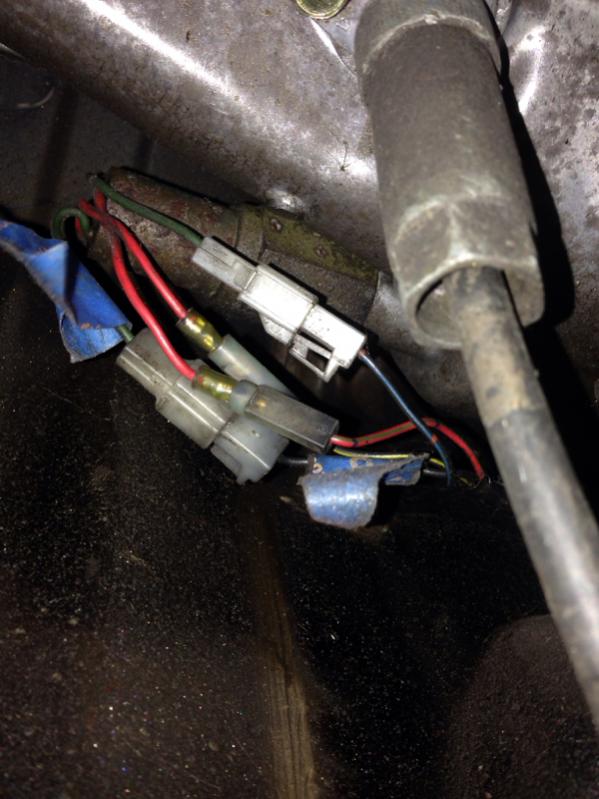

That's what my roomate has.. And that's what I have..
Attached Thumbnails T2 tranny swap on na harness?-image-1873889514.jpg   T2 tranny swap on na harness?-image-1483875355.jpg
Old Jun 19, 2014 | 10:53 PM
Tui's Avatar
Tui
Joined: Oct 2013
Posts: 315
The one of the right is a JSpec back-up light switch with one of the pins broken off.
The one of the left is an ASpec back-up light and 5th gear (emissions) switch.

Originally Posted by Tui
The one of the right is a JSpec back-up light switch with one of the pins broken off. The one of the left is an ASpec back-up light and 5th gear (emissions) switch.
How can I make it work?
Old Jun 20, 2014 | 12:52 AM
Fleemer's Avatar
Joined: Feb 2009
Posts: 290
From: Victoria B.C.
^ repin/rewire it all for matching connectors.
