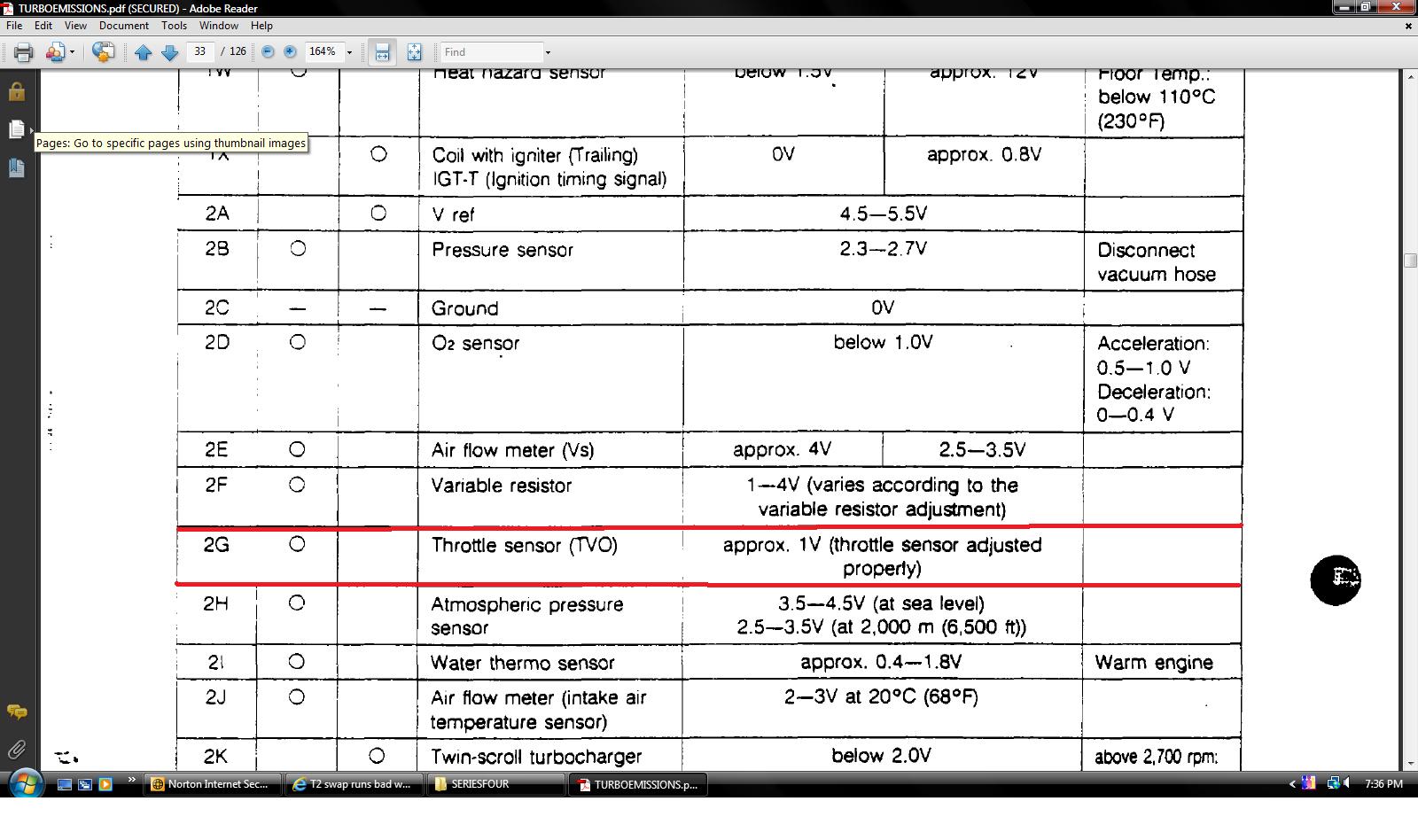

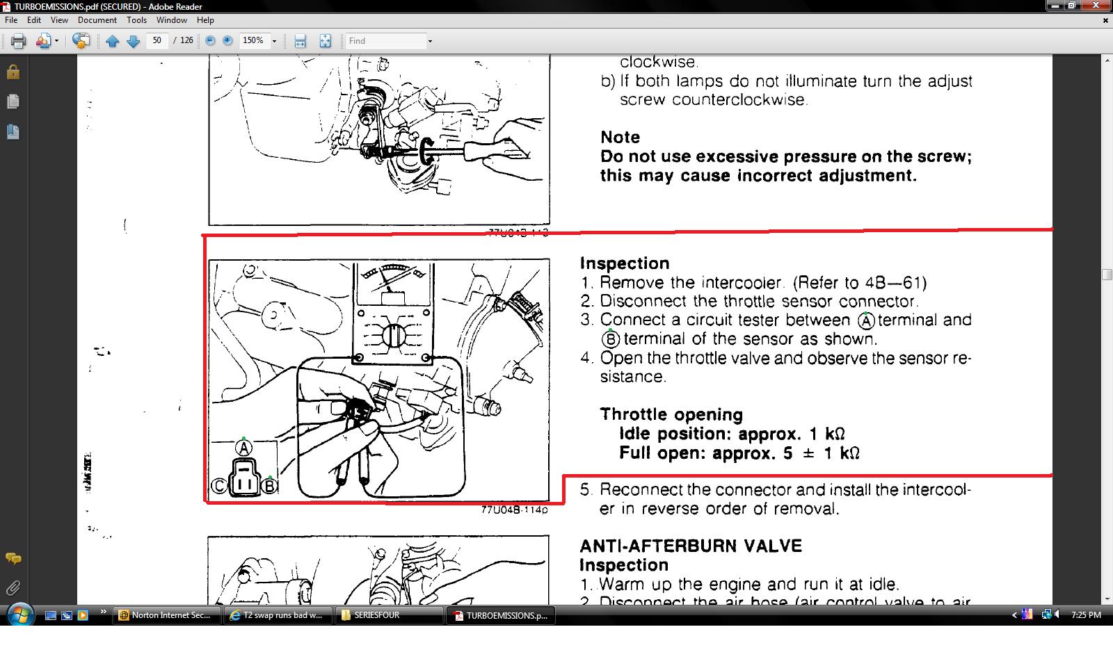

Originally Posted by mxrider914
Also, I think I tested it on the green wire and the black wire(maybe it was brown) That's how it said to do it on fc3spro.
Go to the FSM to check out the TPS as shown in the jpg attached.
Do that. then check A to C in the attached jpg. Its results should be just the opposite of when you checkd A to B.
The output of a properly set TPS results in the TPS outputting a signal of approx 1vdc (See your FSM, Fuel and Emisisions section, sub section CONTROL UNIT for the TPS input on pin 2G {approx 1vdc with hot engine}.
You can check the output of the TPS with a digital meter backprobing the green/red wire of the connector that connects to the TPS ...connector. The engine must be HOT to do this so the water thermowax/fast idle cam etc are in their proper positons. Or backprobe the ECU pin 2G at the ECU for 1vdc with a hot engine either idling or just key ON and fully hot. Frankly I idle my car fully hot doiing this (prior to owning a RTEK 2.1.).
Using a non turbo boost/pressure sensor with a turboII ECU makes for a crummy idle. Same can be said to some extent using a non turbo afm on a turbo engine/ECU.
