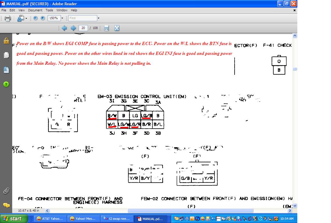

Or go to the SMALL plug on the ECU. Pull the plug off and look for batt voltage on the two pins to the far left on the PLUG as you look at the plug from the wire side. Power should be there. If not, then the Main Relay isn't pulling in or the two EGI fuse are bad.
While at the small plug, see if there is power on the four injector wires. The light green, light green/red, light green/black, light green/white. If not, then the Main Relay isn't pulling in or the ENGINE fuse is bad or the two EGI fuse are bad.

Thanks hailers,, I also checked your advice on checking for power on that small ecu plug and the main i s pulling in I'm getting power the whole nine yards but ill check tomorrow on the fuel lines being in the wrong order, thanks again for the input from all of you.
