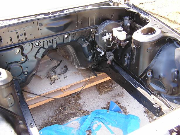

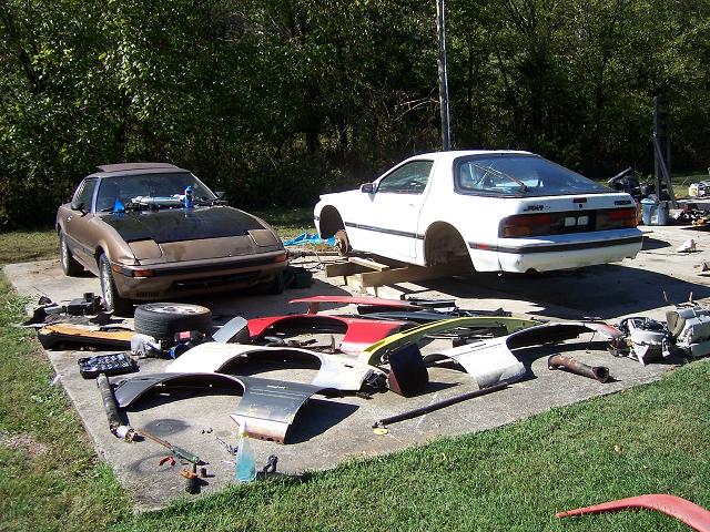

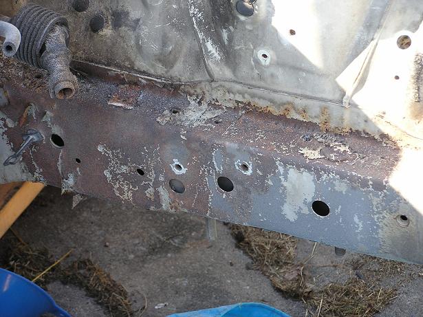

My brother in law is restoring a 1988 T2 for his Senior Project in High School. He ordered a j-spec today from www.osakajdmmotors.com after shipping and removal from the truck at his door the motor ended up costing $1000. Not bad for Motor, Tranny, turbo, all accesories and downpipe, along with an uncut wiring harness....
Anyways he is painting the car black with my help and the car was originally white so... We stripped the car down to the bare frame sandblasted and wirebrushed the whole thing and now we are going to re-install everything when the motor arrives on monday.
Here are a few pics of the progress, I plan to do the same thing to my Convertable this summer...
BTW that is bed liner in the engine bay... It is sweet!
Not bad for a 17 year old... Kid and car are both born in 1988... Anyway I will post more pictures as he progresses....

I've seen it done on several musclecars, it holds up very well. I mean paint stays on.....
I think it will be fine, I'll post results though, who knows...
Old Nov 30, 2005 | 02:08 PM
trochoid's Avatar
Old Fart Young at Heart
Posts: 15,145
From: St Joe MO
I've done the bedliner on a couple of bodies with no issues at all. Holds up to the heat on my 12a-bp. I get carried away and do everything that doesn't get body paint, all of the underbody, fenderwells, engine bay and fuel tank, good stuff.
I did find a little peeling on my Z where I didn't get the surface prepped properly. I usually sandblast, make sure all rust is removed, acid etch primer, an epoxy coat, then the liner.
Keep up the good work, it will last many years with proper surface prep. I like how easy it is to clean up, plus being grease and chemical resistant.
