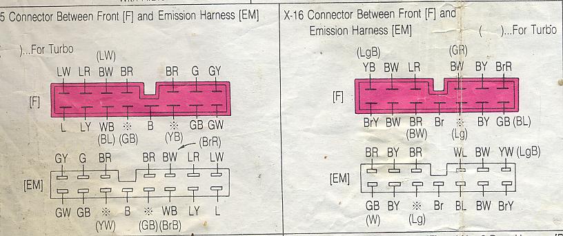

Personally I'd NEVER use a turboii Emissions harness on a n/a car. There is too much mickey mousing to be done to make the Emissions harness mate with the Front harness. The plugs referred to as X-15 and X-16 in the series four manual is what I'm talking about. Do a SEARCH on this forum and put in X-15 or X-16 and you''ll get a couple of hits and on one of those threads you'll see the pinouts for X-15/x-16 and you''' see the differences in pinouts for n/a vs turboii.

See this jpg: https://www.rx7club.com/forum/attach...hmentid=142663
See the ( ) and how those are for turbo? And how they are not for n/a? So it's obvious if you put a turboii emissions harness in a non turbo car with of course a non turbo Front harness..................things ain't a gonna work right unless Changes are made.

CHANGES should be made if you use the n/a emission harness to match the turboii engine. Those changes are fewer and easier in my honest opinion.
All you need is the wiring diagram............the page called Control Unit out of the FSM for the turbo car and Control Unit for the non turbo car and compare them side by side.
