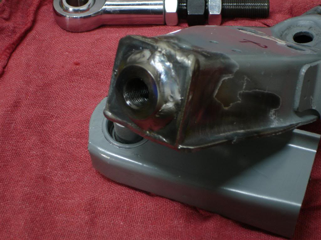

It is possible to replace the OE ball joints in the arms you have now. Ball joints press in and out.
That said, those are pretty cool. I made my own for less money but buying these would have been the easy button.
