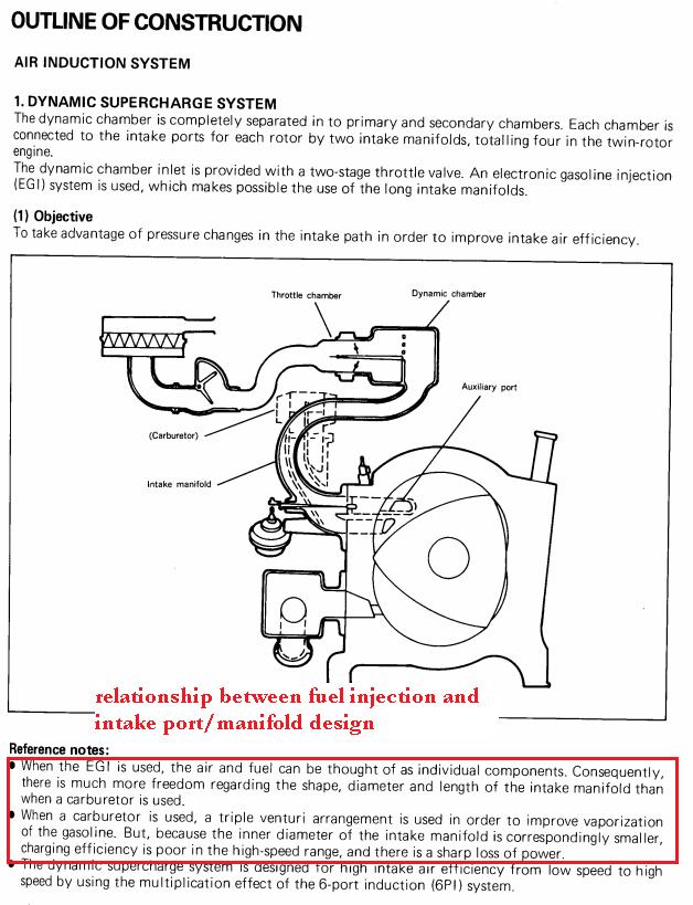

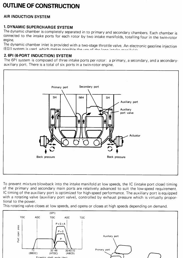

^ your engine is carb'd. Mazda needed fuel injection for a functioning six port system. 6 port systems (and later VDI on s5's) give a broader powerband. In the top end range there's probably not a big difference between the two.
that's from the series 3 GSL-SE training manual
