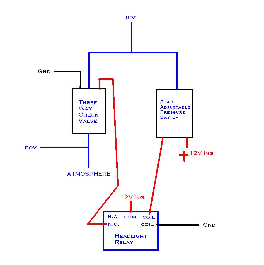

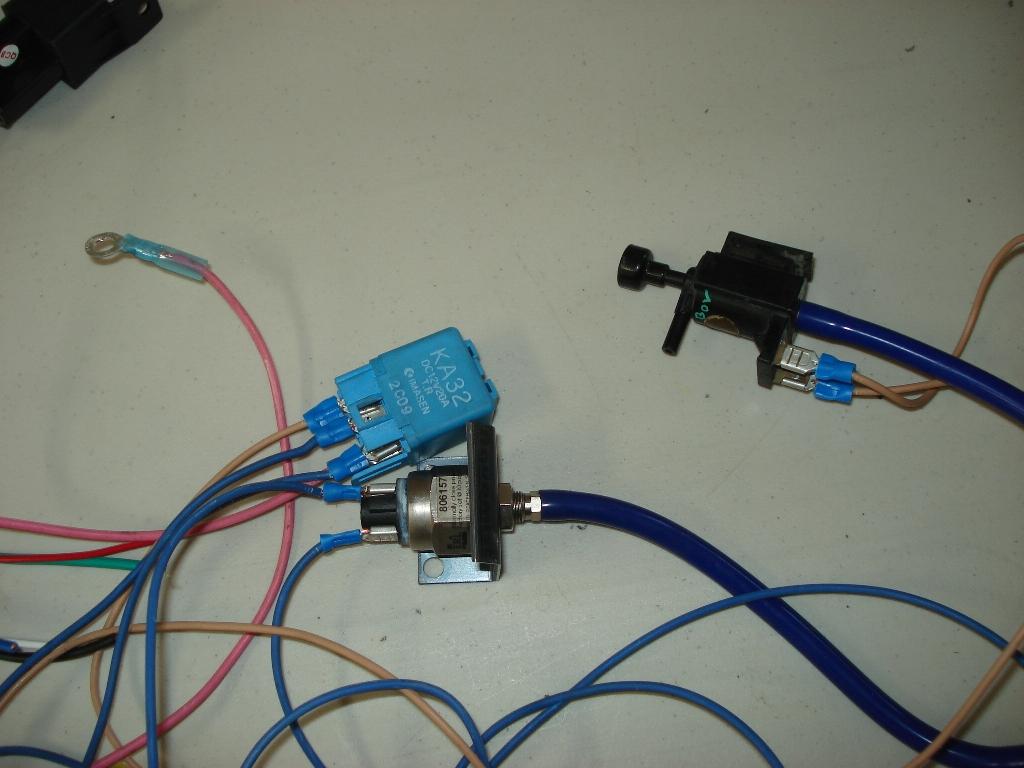

Alright, so I did a bench test on a controller setup I came up with to utilize the POV feature on the Synapse Engineering BOV. Looks like it will work. Will be doing some dyno testing the Thursday before SSXI at Synapse's Dyno in San Diego. I will relay how the testing went, what performance capability this setup provides, etc..
The only thing I'm worried about this setup is how it dynamically affects the EBC and WG. May get unstable flutter when the POV (BOV) goes off, that's why I want to test it in a controlled environment (dyno).
Here's the parts list:
FD3S Emission control three way check valve
Headlight Relay
Water injection adjustable pressure switch - 2bar
Wiring and hose.
Attached Thumbnails Pop-off valves-dsc00049.jpg   Pop-off valves-pov-wiring.jpg

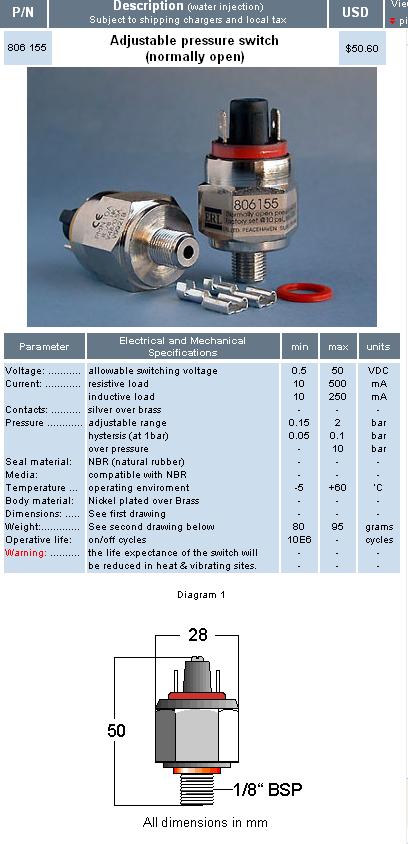

Update got a pressure switch that doesn't require a relay. I went with a Aquamist "Normally Open" Pressure switch 806 155.
Anyways, did some testing and got rock solid pressure at whatever pressure setting on the POV controller. Though, I need to get a turbo speed sensor to get a better idea what the turbo is doing while the POV is open, the turbo may be getting dangerously close to the rpm limit of the bearings.

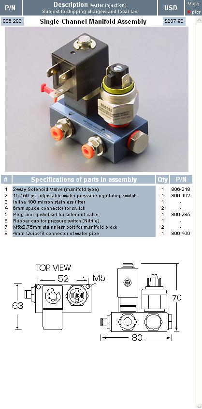

Thinking of making something similar to this Aquamist control unit.
Attached Thumbnails Pop-off valves-pressure-switch.jpg   Pop-off valves-single-channel-manifold-assembly.jpg

It looks like it works 15-150psi. What about the masses that run >15psi? All i'm looking for is a mechanical failsafe.
Old Oct 21, 2008 | 05:27 PM
Joined: Jul 2005
Posts: 2,913
From: Kingman, AZ
No it wouldn't be this exact unit, just similar architecture.
Well what I have is a Mechanical/electrical fail safe, just need to improve the packaging and find a two way check valve that would other than a OEM emission check valve.
