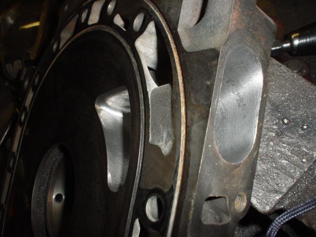

I think if you go a little heavy on the porting it will work. Overlap is the key from what i remember. gonna find out, give me a sec

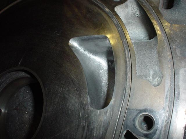

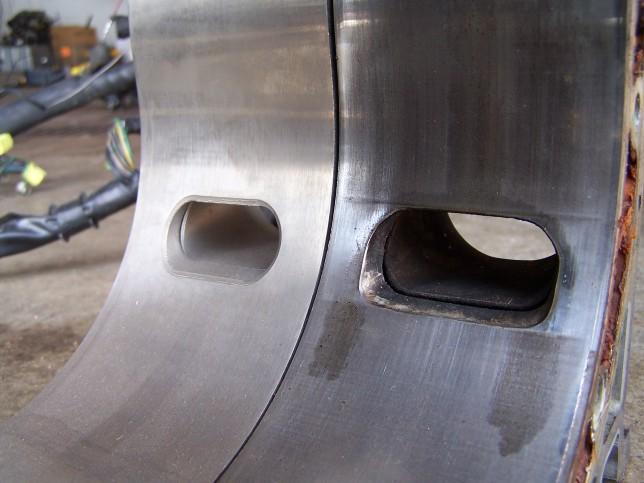

this may retain that pulse lol

oh man thats sexy. what would you call that? big streetport? extend port? stage 2,3 or somethin?

judge ito's porting
hes a member on the nopistons forum
thats the size im going on my 12a instead of a half brigeport will be supported by a 48ida

Yes Ito ports is the way to go! Sounds like a bridge port but its not! Just remember to use the solid corner seals if using this style port!
