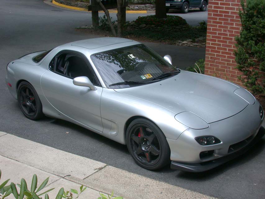

ptrhahn, according to Tire Rack, the 18x10" RGR will fit our cars in the rear only. Can you confirm this? Have you ever tried to put the rear wheels on the front? I'd really like to know if the clearance issue is with the brakes, suspension, or fenders. If it's as simple as trimming or rolling the fenders, 10" front wheels would be nice.
Thanks,
-s-
Old Aug 28, 2006 | 12:34 PM
ptrhahn's Avatar
Posts: 9,287
Likes: 713
From: Arlington, VA
I can confirm that the 10" +42 fits on the rear w/ a 275/35/18 Toyo T1-S, with no rubbing. Does NOT need fender rolling, does NOT require trailing arms.
I won't fit on the front though, don't try it. I have a 9" +42 up front w/ 255/35/18.
p.s., I just acquired some forged magnesium track wheels as the perfect compliment to my BBS street wheels. 18x10 +52 w/ 285/30/18 Hoosiers all around :-)
+52 offset. . .
Do you have issues with the big brakes? I thought you ran stoptechs. . . . or am I mistaken?
Old Aug 28, 2006 | 01:01 PM
ptrhahn's Avatar
Posts: 9,287
Likes: 713
From: Arlington, VA
They're either +50 or +52... supposedly exactly the same offset as the stock wheels, and I can't remember exactly what that is.
No issue with the StopTechs, they miss by a mile... the spoke design allows plenty of clearance.
