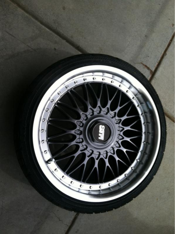

I bought replicas off of ebay and am very happy with them.
But i went with 18x8 up front and 18x9 in the rear with a 3" lip. Kinda wishin i wouldve gone with 17's but oh well.

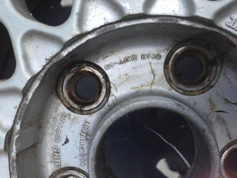

So what do these numbers mean on the original 15" BBS wheels and how can I apply these numbers to find the correct reverse offset wheel?
the bbs verts are 15x6.5 with a +40 offset.
