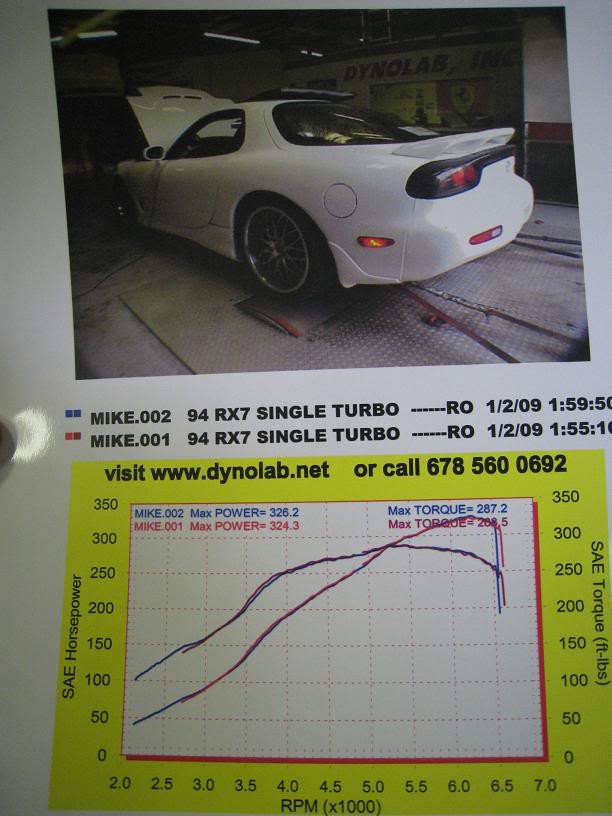

I run the Turbonetics 62-1..
With all the standard supporting mods, I dyno'd 326hp/293tq @ only 11psi.
I like it a lot.
Very smooth powerband, and it works well with the REW.
The powerband starts at high 3's and max HP is at about 6,600RPM..No need to redline.
Dyno pic. Refer to the solid red/blue lines.
Sorry it's kind of big.
LethalDyno-13B-REVS13B-REW.jpg?t=1238789906

^That dyno graph show 272Rwhp and 239RwTQ. Where did you get 326Rwhp..?? Just wondering..
The roller weight setting of my brother's shop's Mustang Dyno is not the same as a Dynojet dyno. It's meant to be more realistic, by showing actual to-the-ground horsepower, versus a Dynojet dyno which is basically free-spinning.
Same exact car. Same exact tune. Dynojet Dyno:
