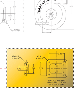

is a t45 flange equivalent to a t6 based? thank u

most likely, yes. do you have the dimensions?

the a/r on the exhaust housing outer diameter size is 25cm (10 inch) and the turbine exducer is 974mm (3.70") turbine major is 100mm (3.944"). This was the info i recieved about it.
Those are dimensions for the turbine housing, but not the flange... You need something like this... this is for a T4 flange.

yeah, the flange dimensions is what I was referring to.

i had a to4e 60-1 installed , i took it of and installed ta45 on the same manifold . so yes the to4 and ta45 are the same
