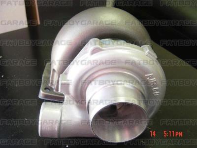

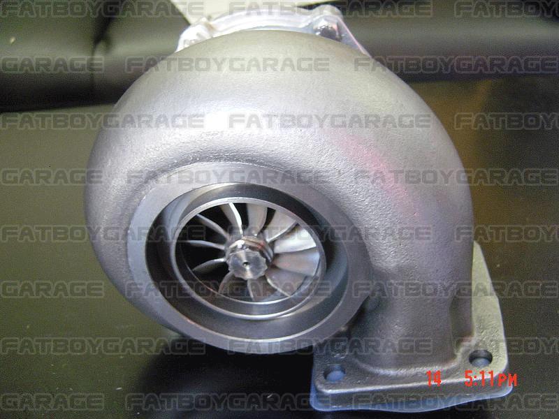

i am thinking about getting this turbo but i was wanting to know if i had to weld a v-band flange on the hot side???? im not too sure on this but i know my buddy with a 7 just did his but he had to use a 5 bolt flange.

yea you have to weld one on.

Ya as stated above you need to weld on the rear clamp system you want.
V band flange, 4 bolt , 5 bolt etc.

so i would need to buy the 3 inch vband flang and have that welded on??

no its not stone mountian racing, or Ss autochrome, its a new crap dealer, read the "specs" he posted
nothin except the junk that comes from china is ever described as this:
SPECS:
a.. .60 - T COMPRESSOR WHEEL
b.. " STAGE V BRAND NEW "
T04 " P "
1.05 A/R TURBINE HOUSING
GREAT FOR RAPID SPOOL!
a.. COMPRESSOR HOUSING A/R .60 TO4E
b.. INDUCER 2.324" / MAJOR 3.00"
for starters 1.05 on a P trim wheel is great for rapid spool????? I don't think so
stage V brand new????? stage V brand new what? both of these are totally different exhaust wheels. one you would find on a mid sized to4e styled turbo, and one you would find on a to4b..... so which is it? is this some wonder turbo that somehow has two turbine wheels ????
he is basically throwing out buzz words in an attempt to seem legitimate.
please, please buy this turbo now, so we can listeen to you whine and cry later about how nothing works right and its all somebody elses fault. We love the whole EMO thing when the crying starts, hell just slash your wrists now and get it over with.
