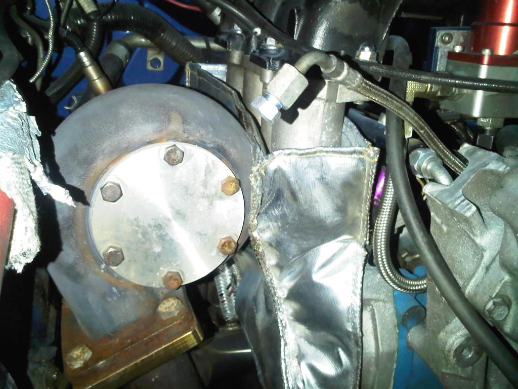

So I went to a local machine shop I knew. Told him I just needed simple plate made of scrap. He gives me this lol... Nice piece...
Tomorrow or most likely weekend I'll go get a cap for the oil line and test it out.

Well, good news, bad news. Finally got around to installing the blockoff and buying a cap for the oil feed. Took it for a 20 minute drive, got home and the exhaust was CLEAN, zero smoke at all. So its not the engine, thats the good news.
Bad news is the turbo is pretty much brand spanking new, maybe 1-2k on it at most, barely ran a month. Arg... what to do.... Here's a pic of the setup ^_^
Note: I did not change the oil or anything on the car so everything was the same as when it was smoking.
I wonder if a GT4094R would fit where the 6765 is....

Are you running a restrictor in the oil feed line or fitting? Is it all the same fittings and plumbing as your setup with lots of miles and no issues? I've heard of several failures from not restricting oil flow to a BB chra.

The Precision BB turbo's have a builtin restrictor so its not needed. This is the same identical setup I ran last season with zero issues except its a new turbo (same one).

GT40 won't fit, turbine housing is slightly bigger. That housing has got nice and hot
On a side note I built a block off plate like that for my Tial 42R housing.. I found I was way too rich in low vacuum past 6k rpms...
